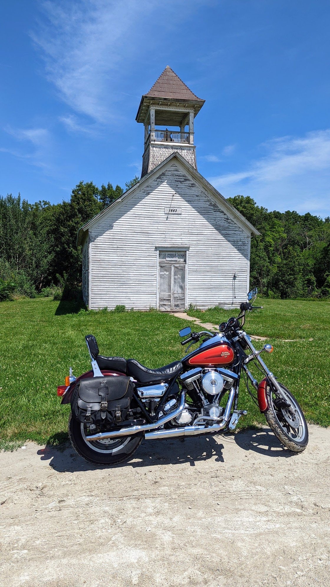

My 90 FXRS Convertible had cast wheels

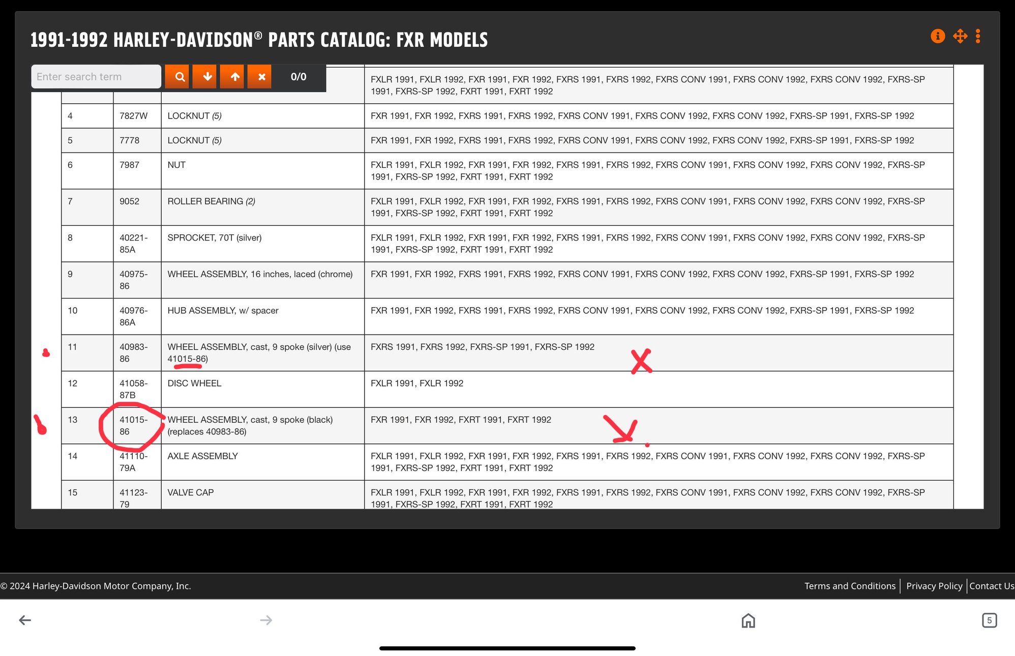

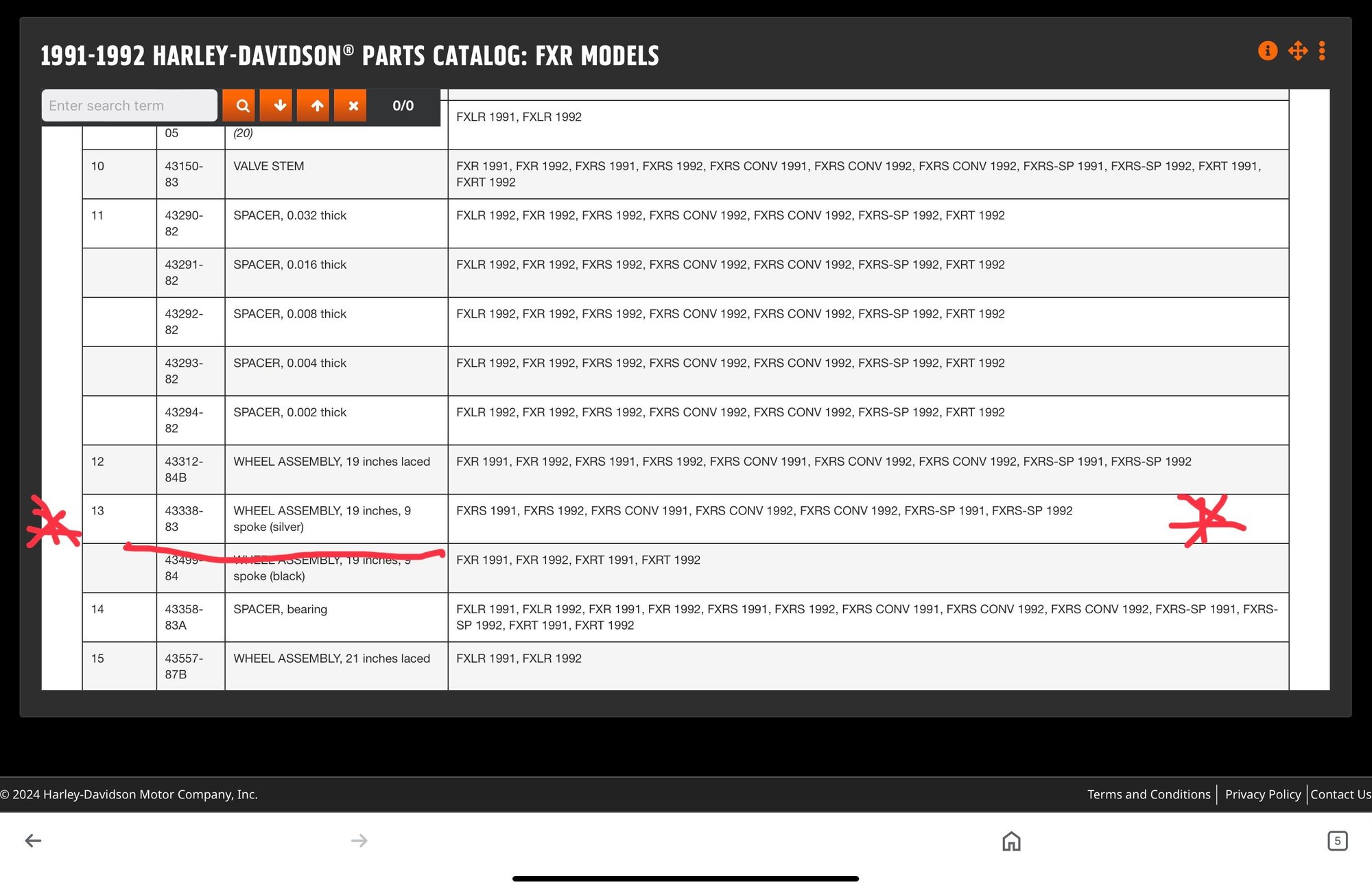

Thanks but if you read carefully I was trying to obtain some factory photos from 1990 /91. That said a combination of help in this forum and some digging around online I am convinced I have my answer. Having got the VIN and using SIP I have also confirmed the bike is a 1991 model year I have the colour scheme I think it Bright and Dark candy Ruby. It is very similar to the in our friends photo above though that is suggested to be a 1990 model year.
What threw me was the previous owner seems to have added a Softail custom rear wheel and a chrome spoked front.
Problem I have now is establishing (with some degree of confidence) the correct part numbers for the nine spoke alloys (front and rear) that the bike seems to have left the factory with so I can try to recover replacements. Is it possible that the factory may have “optioned” alternative wheels during that time?
The SIP reveals several wheel options and confirms a 9 spoke alloy for the front however not for the rear …. I’m baffled.

The FXRS-CONV is shown with Silver 9-Spoke "Mags" in both the 1990 & 91 Sales Brochure. Although they could probably be equipped with Laced Spoke from factory.
You'll probably have to pick out the correct wheels from their visual/physical features instead of a part#. They'll use a Tapered Roller wheel bearing and have the correct size "Locator" (spigot) for the brake rotor ... years 1984-95. Earlier wheels will have a larger "Locator" for use with the smaller 10" rotors. They may list the wheel as up to 1999, but technically Harley changed to the 13-spoke in 1996.
