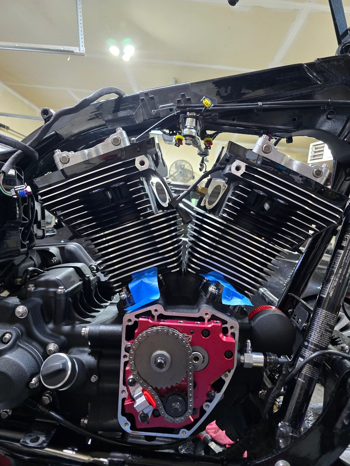

I don't know man, I found a really nice pair of stock touring heads with milled fins for $550 and I am having a really hard time controlling my left mouse click finger.
Good idea on sandpaper, I do have a rubber block, so I'll give that a try next. I am following the stock pattern for milling so the front head in my pic is done. Well, the left side is done, the black you see will stay.
What are you, nuts??? Pay 550 for unknown used heads. Then another what, 8 bills for the head work? To save a few hours of manual labor? You're insane for even mentioning it. Come on now.

BTW start with 320 or so and maybe a quick once over with 600 afterwards if the 320 leaves any trails.

Yeah, you're probably right. I was thinking I'd keep'em in reserve and in case I really bunged this 'job up I could install them next winter.

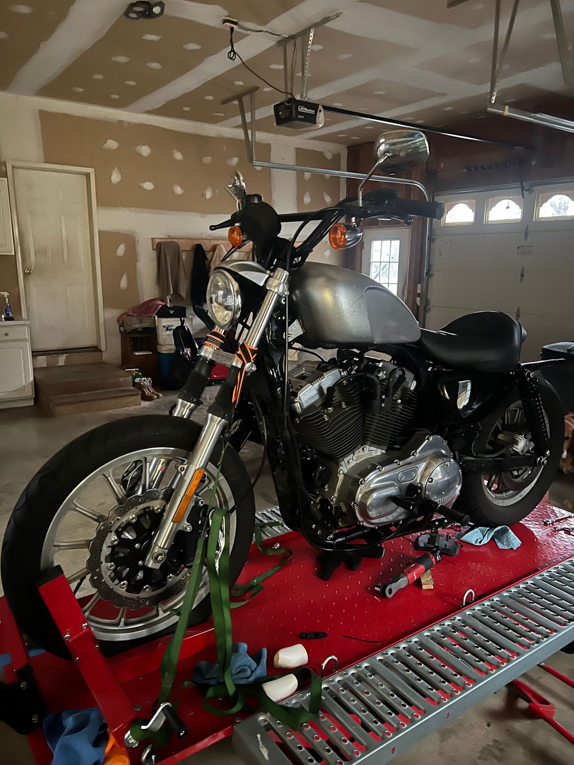

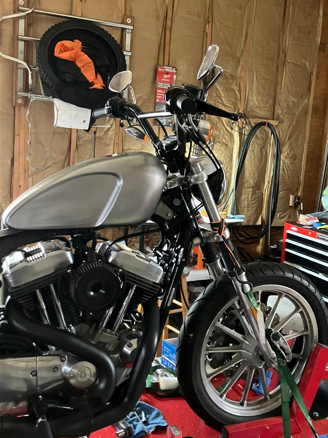

This sporty has grey heads and jugs on a blonde case. Built with some 1200 take offs, a hone and some Weisco 10.5:1’s. Was an 883, with a 4.10 drive ratio, she’s a snappy high-stepper.
I think the mismatch looks cool.

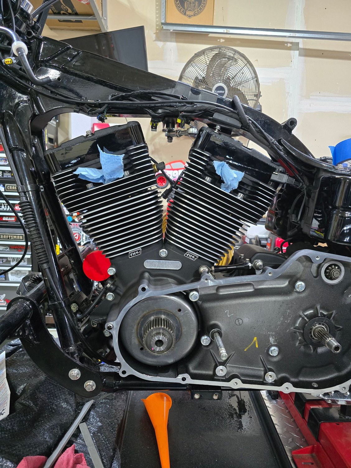

I took @3dognate 's recommendation, picked up an Ace Hardware crosscut file and cut out a small piece that I could get into tight spaces with, and the left-over bit with the handle came in real handy too. Finished off with 320 and then 400 I think it came out pretty damn nice. Not up to my OCD standards because the fin edge thickness is different, but close enough that I can live with it for a min. My shoulders and back are killing me.
