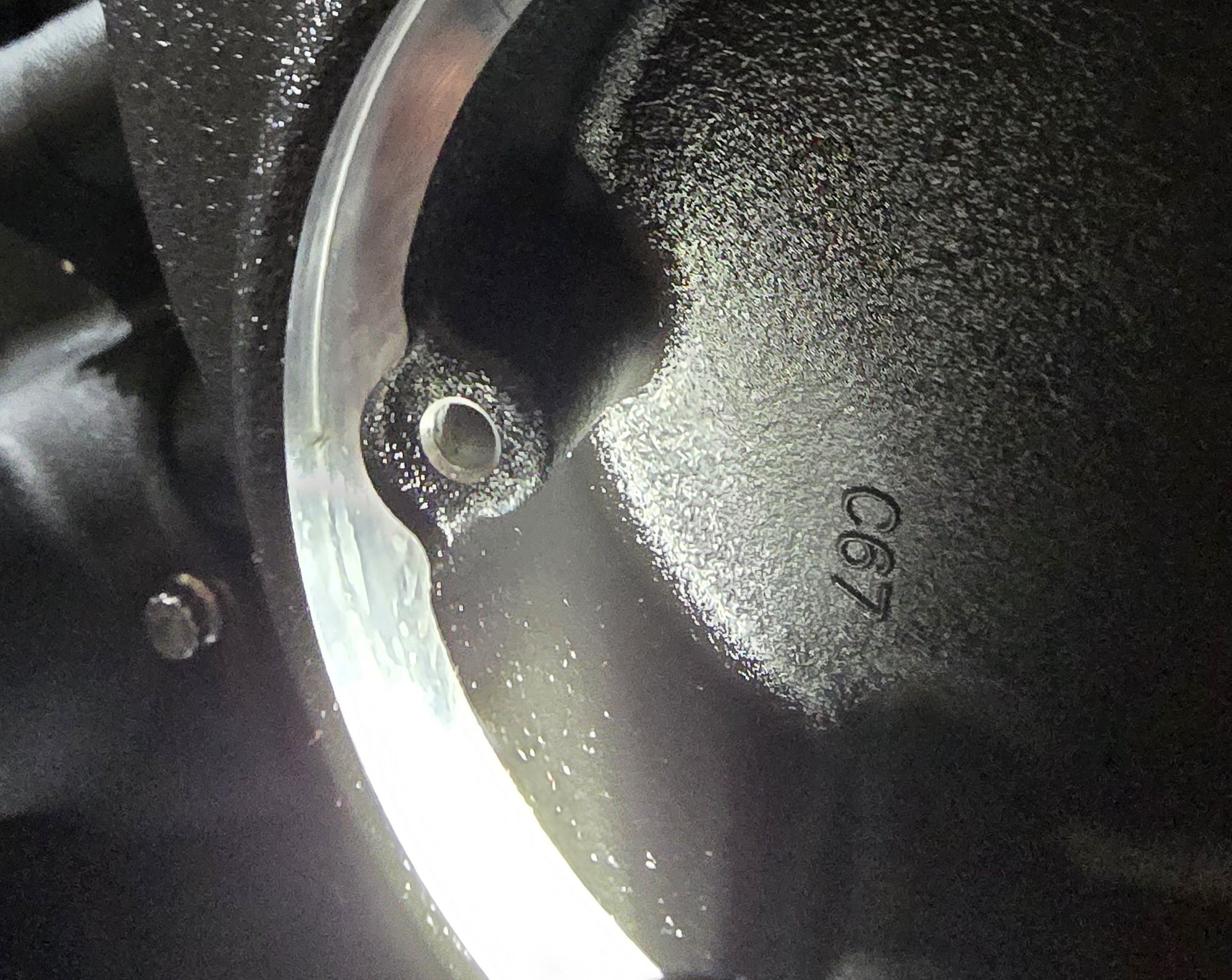

Since I am waiting for parts again, I thought I'd put my freshly powdered points cover on with my pretty chrome Colony, Torx heads (nope, ARP doesn't make anything that small). Do you not see what I not see in this pic?

I was just looking back at some of your pics of the primary chain and am hoping you reduced the length of the spring in your auto tensioner. With all that added torque your tensioner will rachet up and make a piano wire out of the chain..
Also looks like no threads in the timing cover..

Is the cover brand new? If so it probably takes a self taping screw.

It is brand new, but it is also supposed to be tapped. I was sitting there trying to start a screw and I was like WTF?

You are missing what I'm saying.. A new cover likely does not have that screw hole tapped. On assembly they run in a self taping screw.
Something like this..
https://www.fastenersuperstore.com/p...utting-screws?
