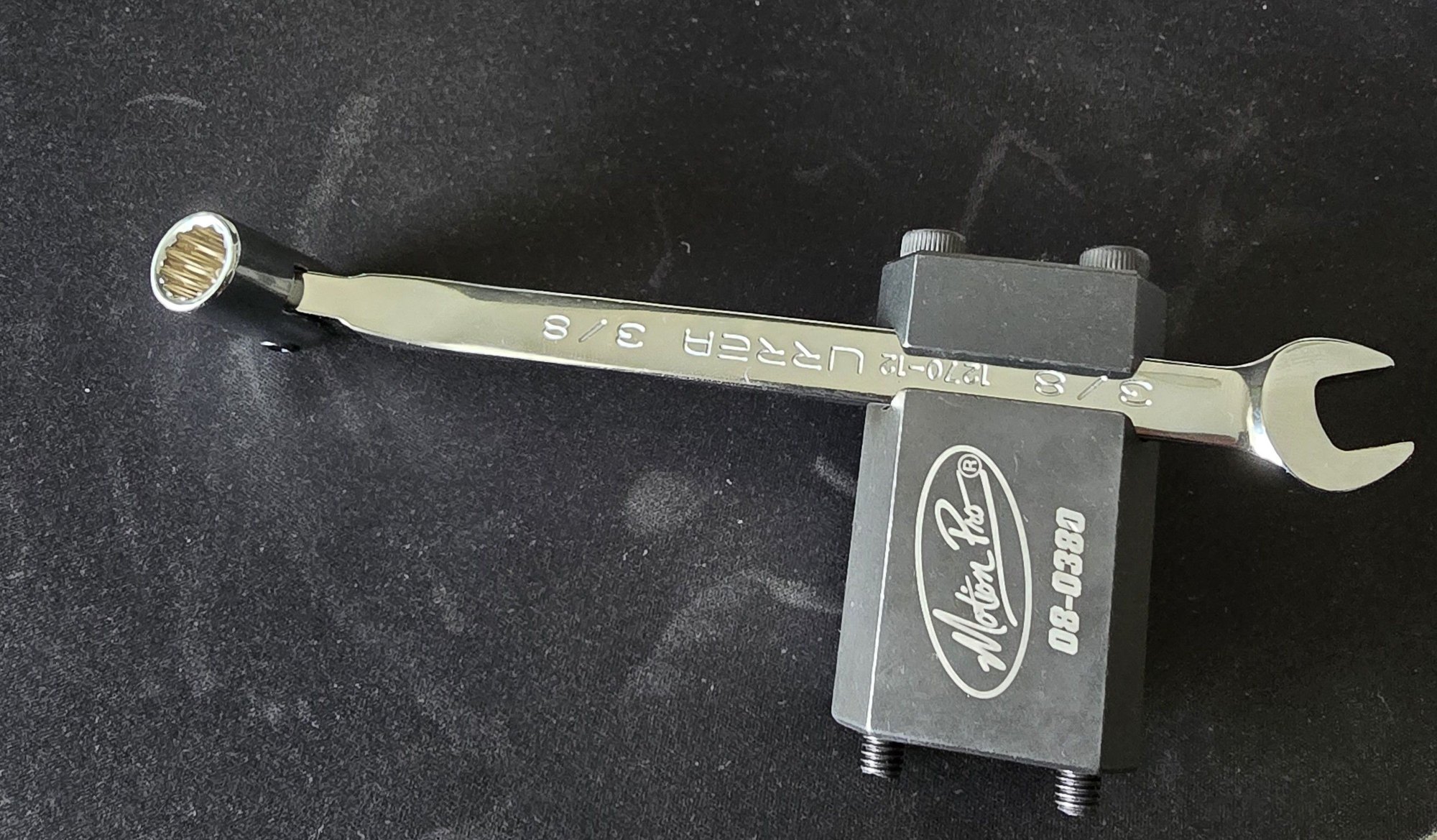

@Mchad I forgot to mention that your suggestion for torquing the lower rocker bolts worked out awesome!

Excellent. You'll be surprised how handy that overpriced block of steel comes in from time to time. Those bucket wrenches too...

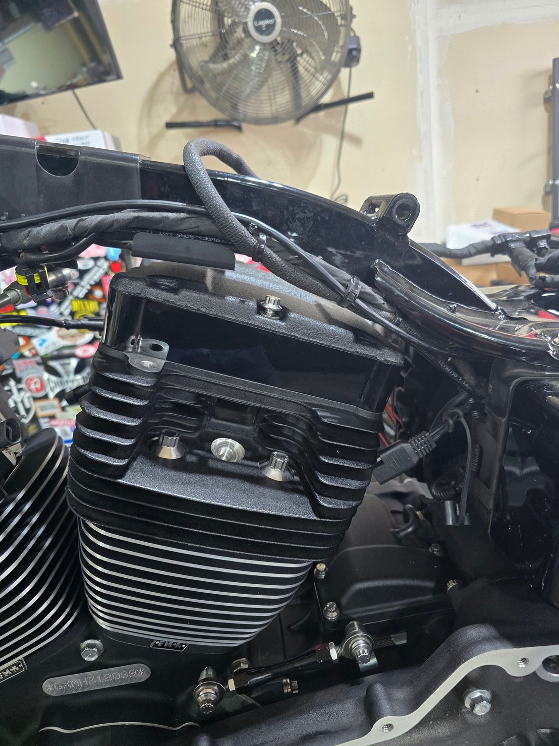

Well, those are brand new, Gen-U-wine MoCo gloss black lower rocker boxes so if re-powdered I'd probably do my stock silver ones. I actually like the gloss though it matches the new tappet covers; I think it's the all-black fins on the heads that are throwing things off. Here it is with the wrinkle black top rocker covers for a test fit and I think it looks good except the dang black fins! Someone a few posts back recommended sanding them and I found a video of a guy using carb cleaner and a red scotch bright and it literally took mins to turn the fins bright. Starts at 1:06
I think I might go that route before changing the lower covers. You are right though; it's going to eat at me for a minute.

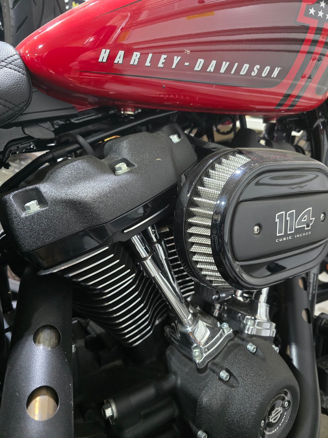

Btw, this was my original inspiration for the gloss lower rocker box and wrinkle upper, my wife's '22 FXBBS. The bright fins make it though, so I'm feeling pretty good when I'm done it'll be awesome...at least from 5 feet away.
