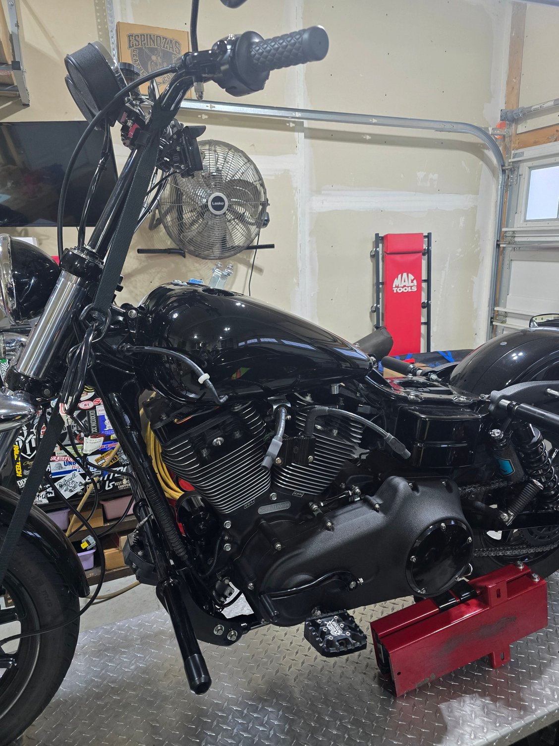

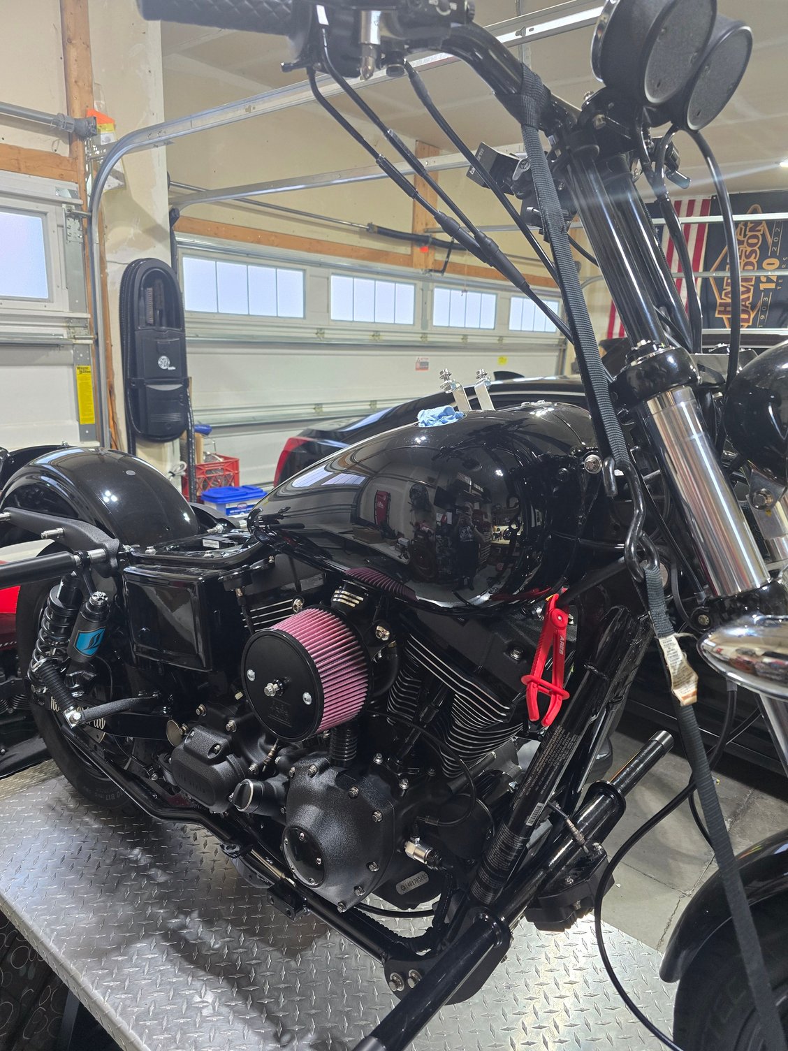

Pretty small and boring update today. Cometic exhaust gaskets were supposed to be here yesterday. USPS pretty much never shows up before about 4pm, but wouldn't you know they "attempted" to deliver at 11am yesterday when the entire neighborhood was under 8+ inches of snow. I hate to say it, but sometimes it really does seem like they do **** like that on purpose. I mean think about it, they can just drive through their route and go right past all the mailboxes and driveways that aren't clear yet and mark them all "attempted", it'd make for a pretty quick and easy day.
But I digress. I got the air cleaner and tank back on and figured I'd do some paint correction since I know what I'm doing now, and it won't take long.
