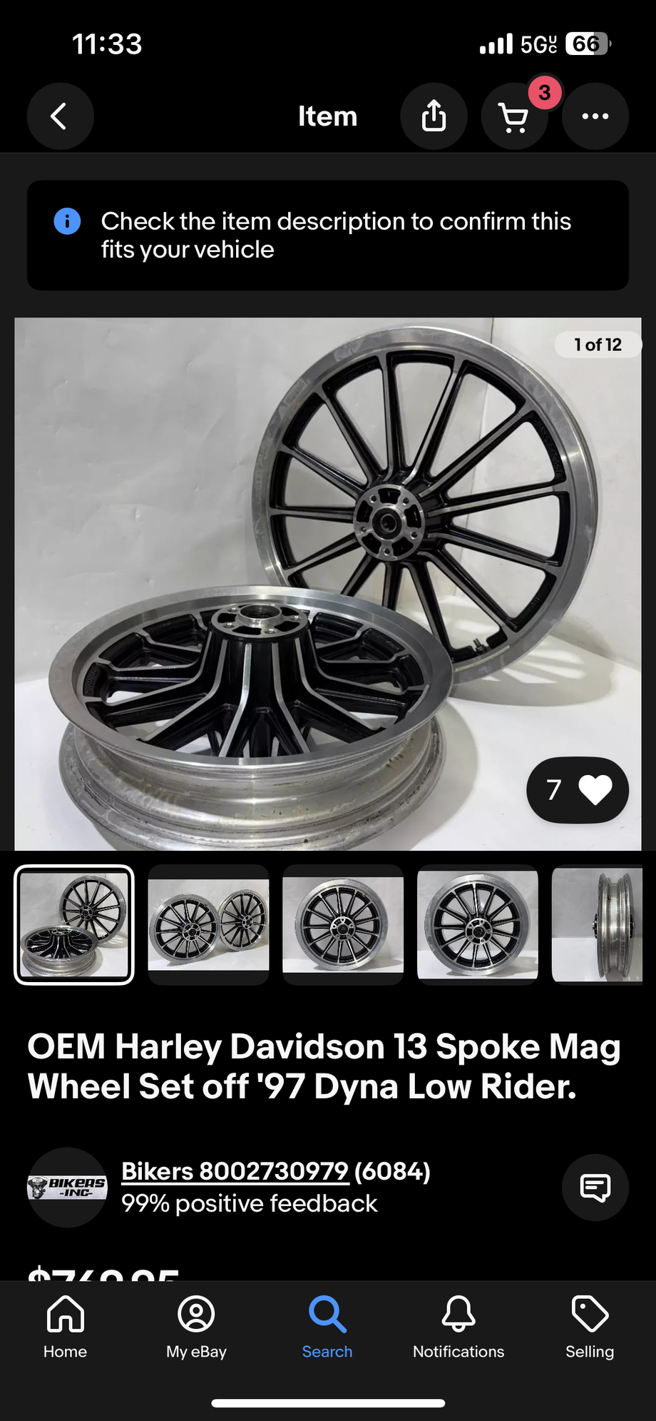

Thank you guys for the Info so I found some mag rims from eBay but I’m a little confused with the bearing size idk if they fit my 2007 Lowrider so if you guys could help me would be great thank you ima also post some pictures of the rim details

And I know they’re not the oem rims just wondering if this fit or not or if the bearings size are good or if I could change the the bearings size and will fit on my bike

No they will not fit your bike
those wheels have 3/4" tapered element bearings just like the ad says ( also has an option to check fitment, did you do that??
your bike has 25mm sealed ball bearings
06-07 have 1” bearings. Dynas went to 25mm starting in 08.
