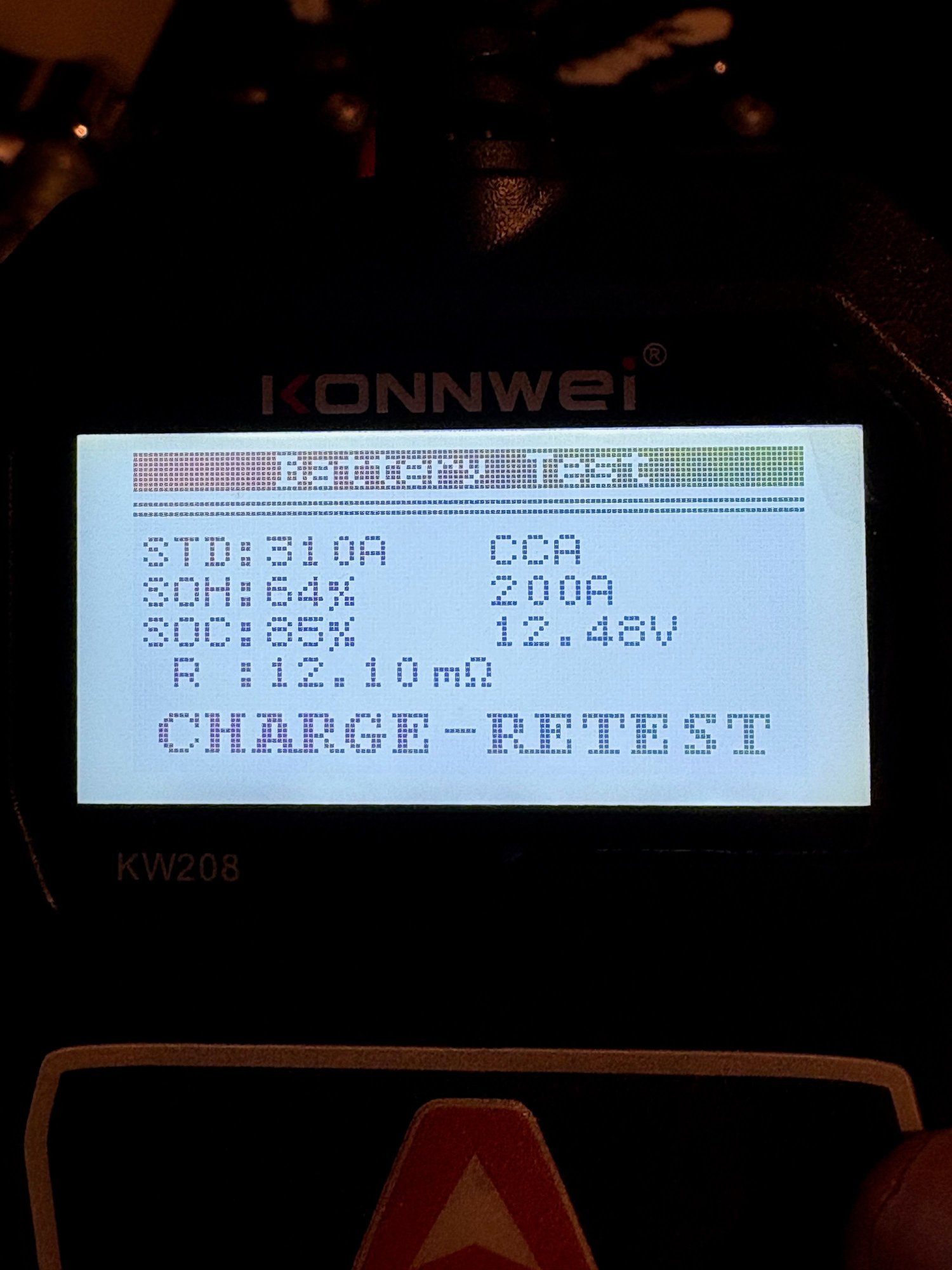

I got these results with my tester. I will still hit it with a multimeter. Also, it did another "slow, dragging" crank.
"cranking normal", supposedly. How do those numbers seem?
Also, tested the battery immediately after the crank test and the stats look like crap now (below):

It dropped as low as 5-6v while cranking.
That could mean the battery is toast, or it could also mean the starter is drawing to much current (also toast). Did the voltage continue to drop the longer you cranked?
If you have access to another battery, or can safely jump it, does it crank OK?
