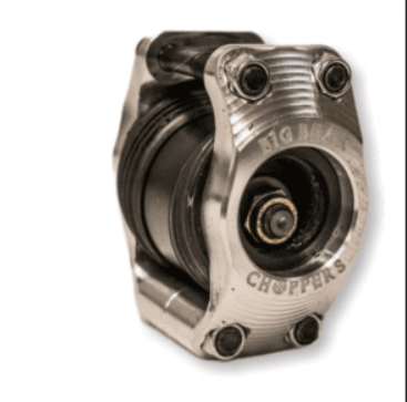

Still rocking the Big Bear Chopper rear mount.
I don't see them selling them anymore. They were expensive $350.00 then.
I had to disassemble the mount to fit it in there. They were meant to install with the engine out.
What a PIA. Anyway, it's been solid for lots of years now.

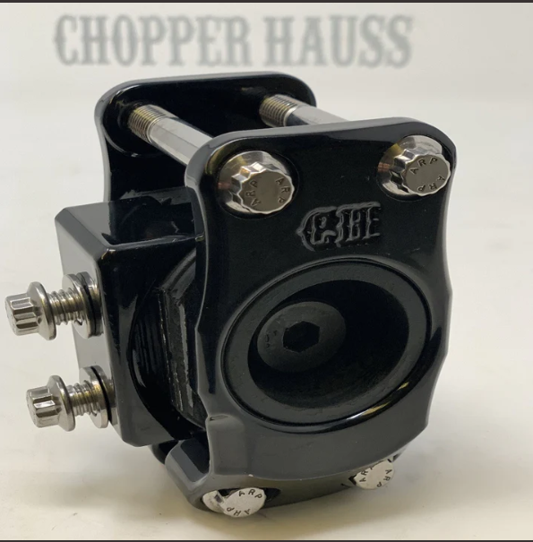

Chopper Haus has a similar one. $400.00 !
