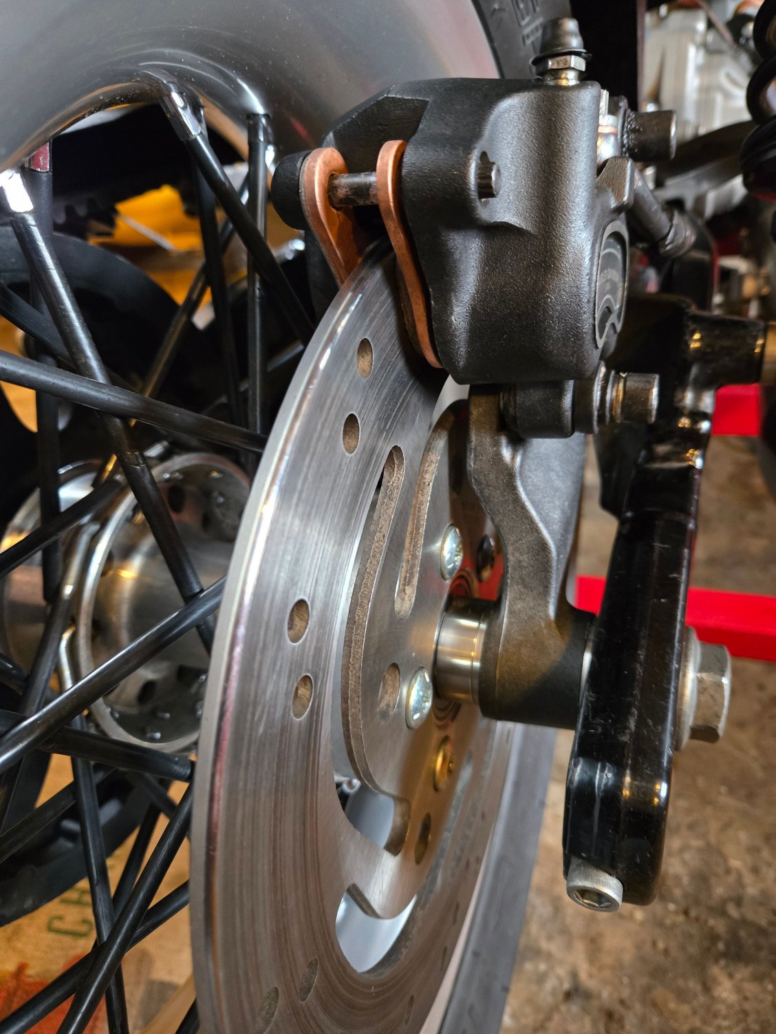

When I pull the wheels, I usually do the brakes at the same time.
I found my front caliper to have sticking piston and they brake pads were worn uneven, like only one piston was worksing. I bought a real nice rotor and have a newer caliper to install, moving to the rear I found the rotor rubbing.
I have an updated one from ebay coming with a replacement rotor. Not new just allot better.
I notice the bushing on the current caliper are worn along with the pins. I'm thinking that's what happened as to why the rotor rubbed.
I'm thinking it sticking floating caliper.
I will make sure replacement has normal movement in the brace.

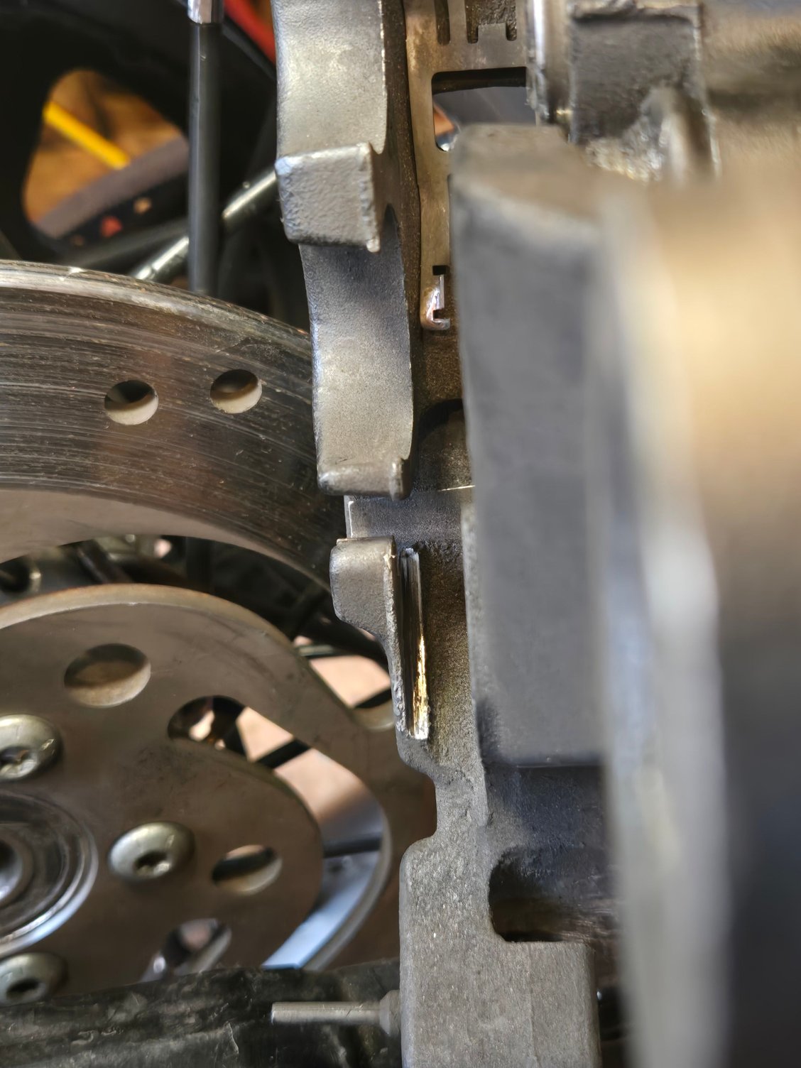

I was thinking of using a .05 shim to move the rotor towards the center of the working area of the caliper. The one shown is a .062 but I also ordered a .050 that I would try first because of the location land.
Don't know if that is a great idea, but I will try without it first and the updated calipers assembly and used great condition rotor.
From what I see the rotor needs to move outside a little.
I know the pads were worn but still within specs so it shouldn't be rubbing the caliper assembly.
