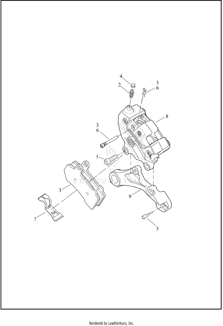

My 2021 Road King uses a solid mount rear rotor. I am upgrading my fronts to Arlen Ness 14" rotors and was looking at some rear rotor options. I see Galfer offers both solid and floating rotors, both show fitment on my bike. Can you use a floating rotor where a solid mount one is intended? I'd think that may cause a little too much float as the caliper floats, right?

I have an EBC floating rotor on the rear of my SGS, and it seems to work just fine. I haven't paid much attention to the rear caliper, but I don't think it floats does it? I hope that wasn't a seriously stupid thing to say, but the caliper is hard bolted the a bracket that doesn't move, right?

Ok. maybe I'm wrong. I thought the caliper floated. I thought one had to - either caliper or rotor, and the rear stock rotor is hard mounted?

Definitely stick with solid mount rotors when you have calpers that float and yes yours float.
the caliper is actually centered up when brake is applied to the solid mount rotor, this keeps it aligned for wear.
The front has floating rotors because of the small caliper mount design and solid mount.
