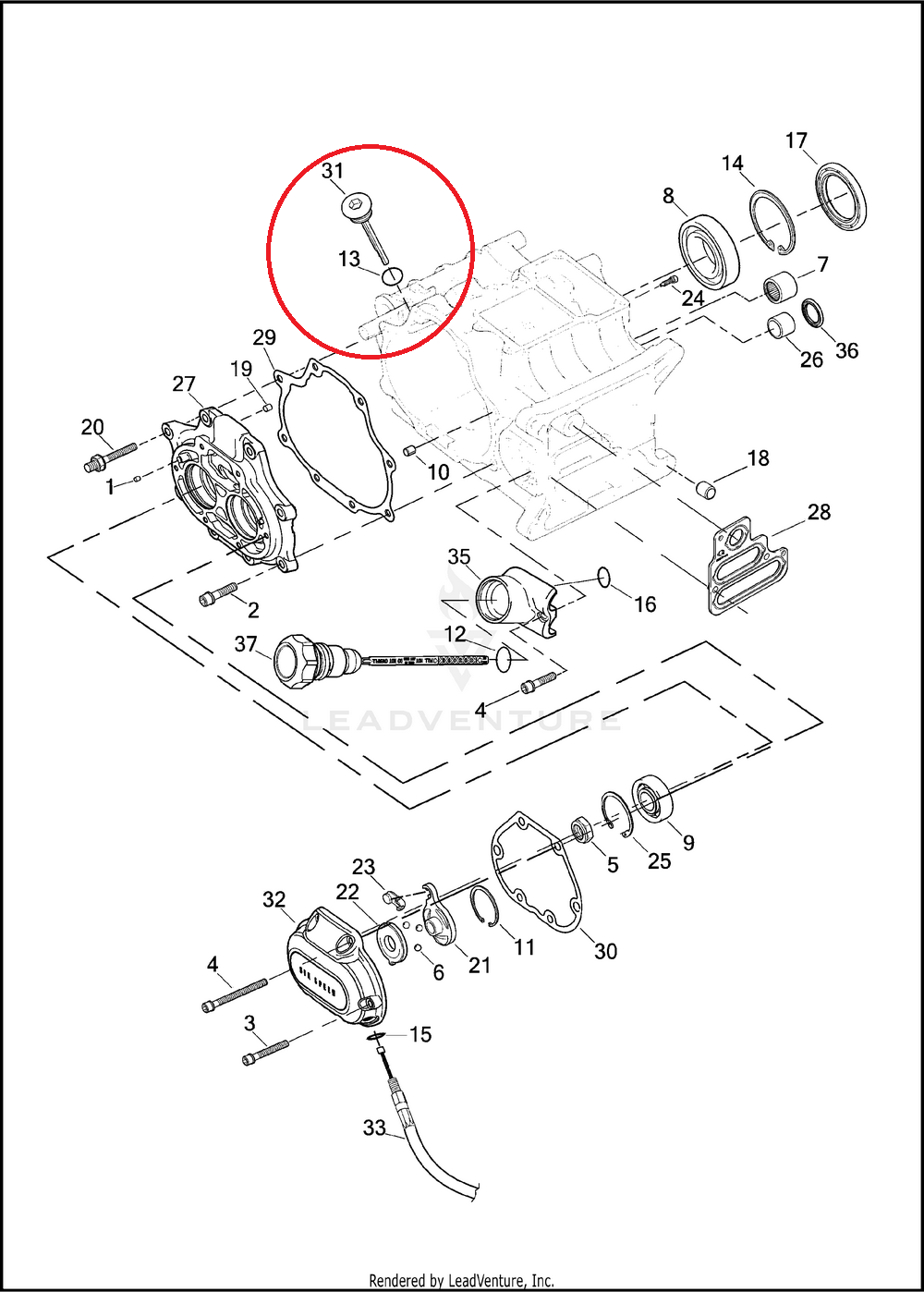

New to me 2016 Dyna FLD. I removed the ABS module to change the transmission fluid. Previous owner must have loved air tools because the torx head snapped. I was able to get it out but I can't find my thread checker to buy a replacement.
Does anyone know what size bolt that is?

This screw? Don't know why you would need to remove the ABS to change the transmission fluid. You can access the dipstick (fill port) without removing other parts.
Ref:1
943
SCREW 1/4-20 X 5/8 SOCKET BUTTON HEAD
Price: $0.59
