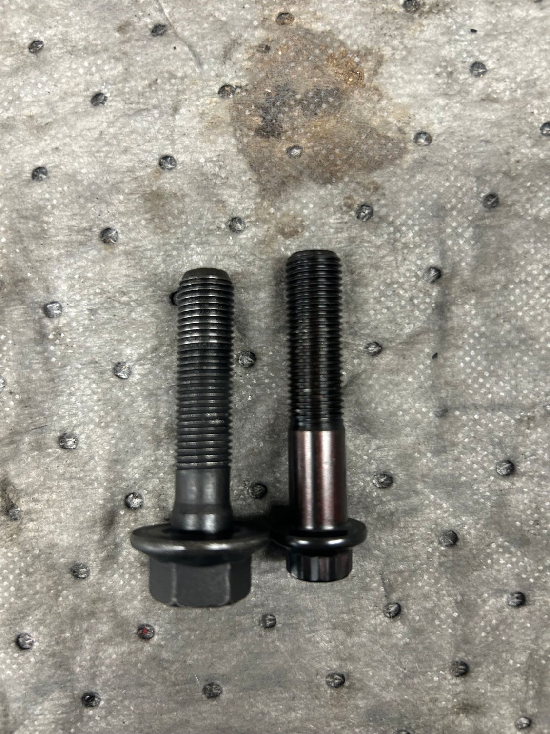

I ordered new S&S bolts and the cam bolt is a little longer, and there are less threads - is this an ok replacement? This is a 2004 TC88
If it's the prescribed replacement for your bike, then you're fine. If it were me, I'd get a depth on the counter bore just to be absolutely certain that bolt won't bottom out.
