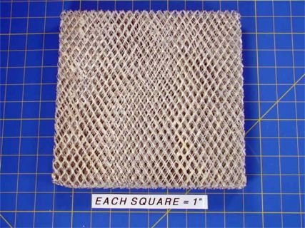

dude i do this on rockets all the time... here is how you make grills for it!
- go to home depot and get some screens like you use in a stove, for the fan, they are silver and have 2 screens per filter with some silver mesh crap in the middle
(i use this cause it is very light, easy to work with and mold)
-cut your sections, from here you can push the sceen a bit thought the openenings so that they look like they where molded to the dash and not behind it...
- i secure it all down with silicone cauk around the edges
*i have done this on prob 10 rockets now, never had any issues with it getting loose or anything... i am actually going to be doing the same on my TX500 build so i can take pictures if you need it... i will look though my PC to see if i have nay pics of the rocket grills i have done. super easy to do
the screen looks like this and each piece gives you two decent size screens:
*I just looked all though my work PC, no pics of the grills, i emailed a buddy i work wiht that i did his bike to see if he has any... ill post some when i get home, super easy to do man the the results are AWESOME!!!
