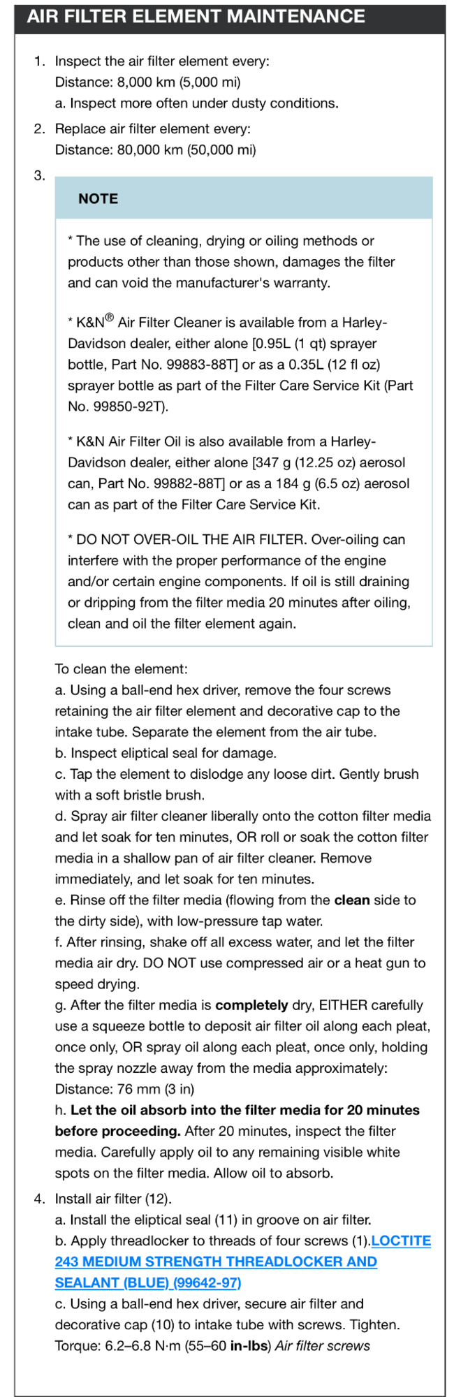

Originally Posted by pgrchaplain;[url=tel:21643059
21643059[/url]]WAY TOO MUCH OIL!!!!!!!!!! K&N also suggests 50,000 Clean and Re Oil interval.
Not for HD K&N filters. Even inside the cleaning kit K&N sells at HD dealerships, it consistently says to inspect at 5k, clean, replenish oil. Replace at 50k.
