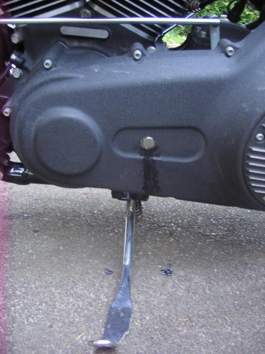

Primary leaking from mid shift cap

Originally Posted by JRK5892
pop off the cap, i filled min with permatex "the right stuff" then put the cap back on... put a 2x4 under the kick stand and give it an hour or so to dry
That sealed it for me. 2,000 miles and no issues.

Had the same happen to me..the gasket shifted,took them 20 minutes to take the primary off and replace it and bolt it up again.
Attached Thumbnails Primary leaking from mid shift cap-sbsweden-090.jpg   Primary leaking from mid shift cap-sbsweden-115.jpg
If your lucky...then it starts leaking from the back
Lol... Mine just started leaking from the back side.. Guess it's time to take the cover off.
