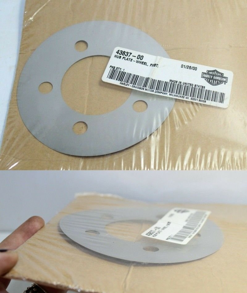

@johnwesley, Getting Back
The simplest solution would be to use this Blank-off Plate/Shim# 43837-00 (see the Bay link below). It's really intended for the Brake Rotor side so you may have to enlarge the holes for 7/16" Pulley bolts. I would use a touch of sealant between the plate and hub mtg surface.
What brake rotor are you using? ... the original equip?
** If you end up getting that blank-off plate, I'm really interested in the Hole Size as supplied
43837-00 theBay current listings

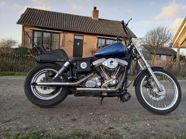

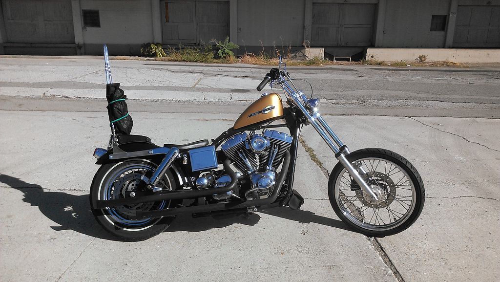

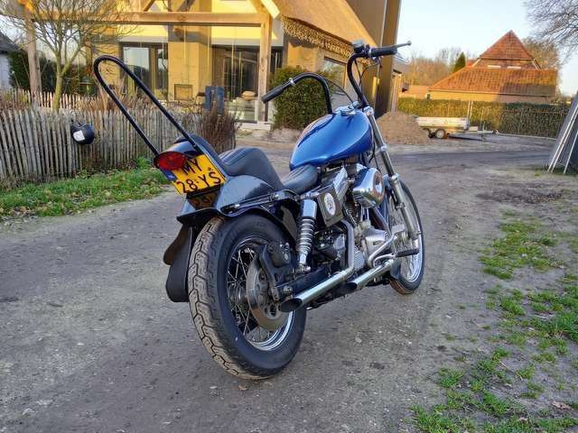

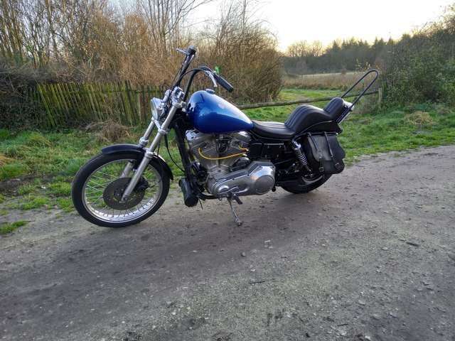

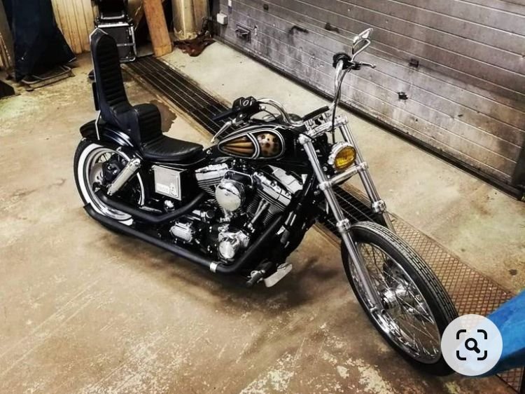

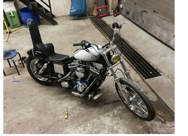

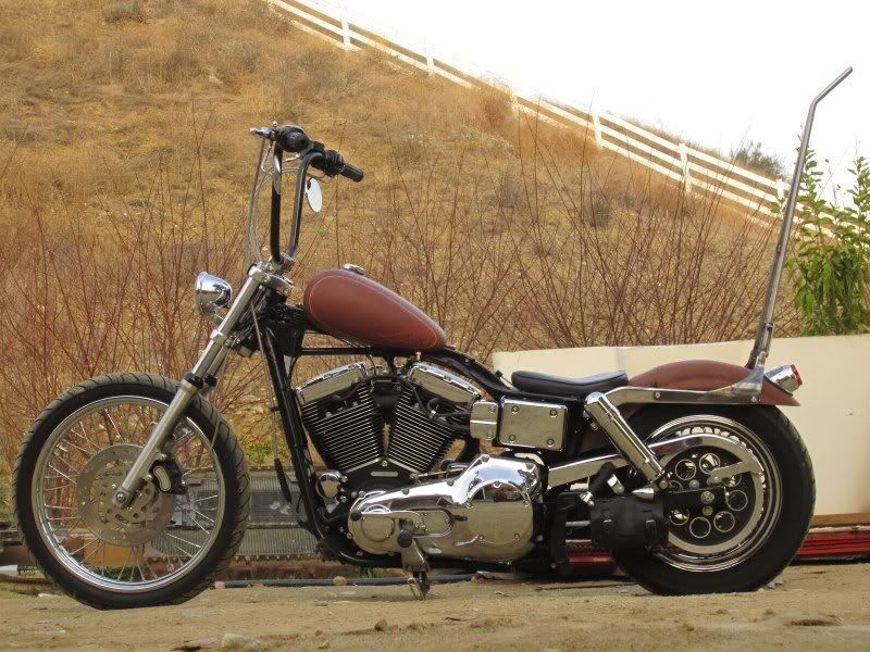

Here are some chopper Dyna from the net.
I’m using oem 2008 fxdb brake rotor.
thanks for the update, I’ll check that shim out
