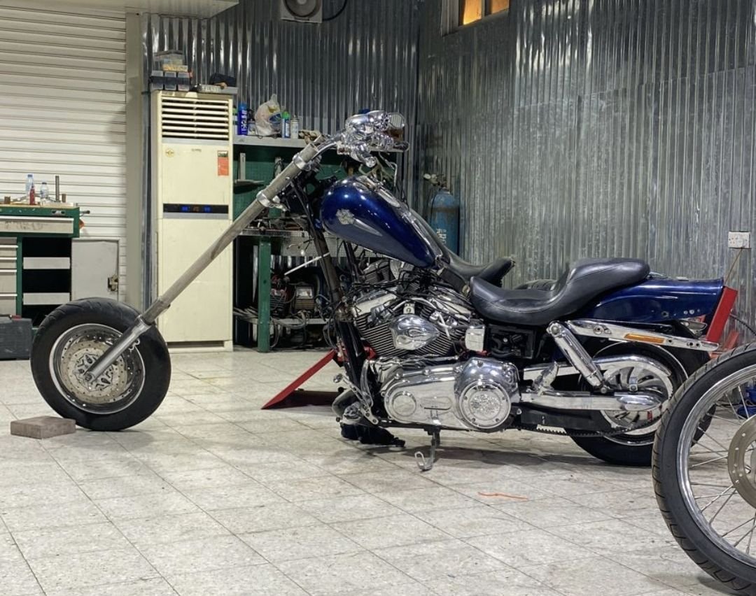

Originally Posted by Crazy
49mm tubes?
ya 49

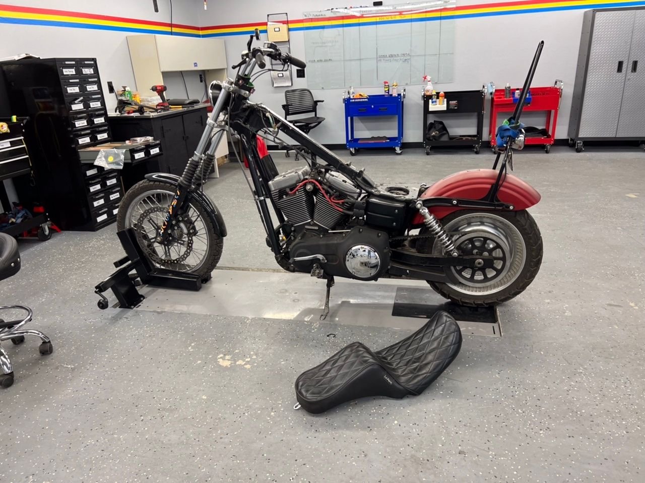

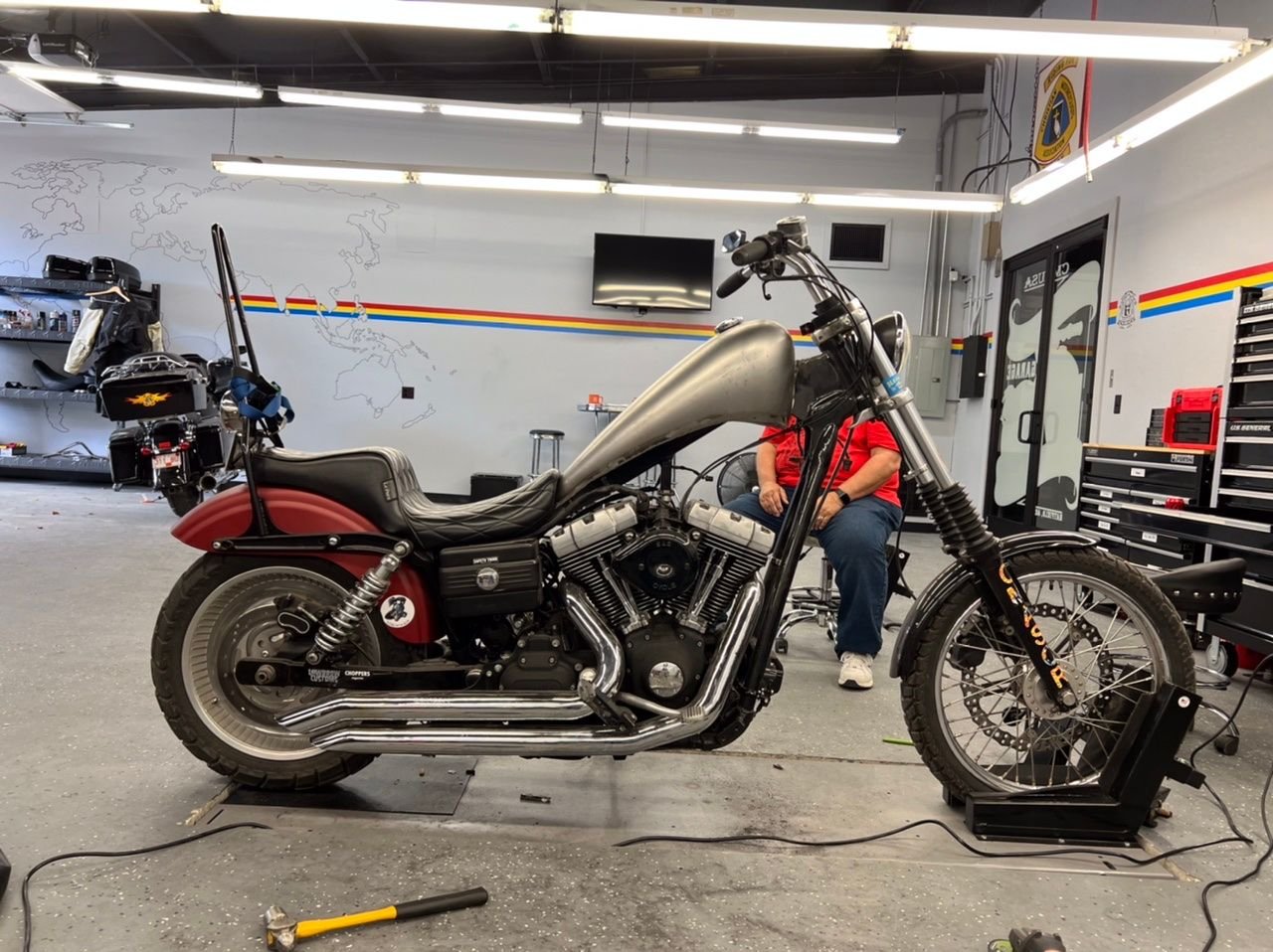

Mine is going under the knife again to help smooth out the lines with a new tank. Probably going to redo the back bone and possibly the down tubes.
The tear down for a remake
Fitting up the tank to get an idea on the lines
You gonna rake the neck a little???
we’ll see how it goes, it’s at 32.5 now don’t want to go any further than 34. My trail is about 5.5” now. I may tray some 2* trees, that would put me close to 3.5-4” I just haven’t found any that look nice yet.

I set my trail on my 98 Fatboy to 4.8 or 4.9", I forget exactly and now the handling in the Twisties is awesome.. More like a Softail Custom now..

getting the frame cleaned up for the new backbone but I need to decide if I want to redo the down tubes or just weld in gussets to tie the backbone to the down tubes.

Based on your last couple of thoughts 3.5- 4" of trail Is not going to be stable at speed. Seeing where you have the frame at now I would just change the rake right there and then yeah you're going to have to use some kind of gussets to tie that back in but 2° in the frame I think would be better than 2° with a set of trees..
im not trying to get more rake, just if the trees may pull trail into the 4 range. That said I’ve not seen anything that has the looks I want for the bike. I really like these cleaned up sportster trees
