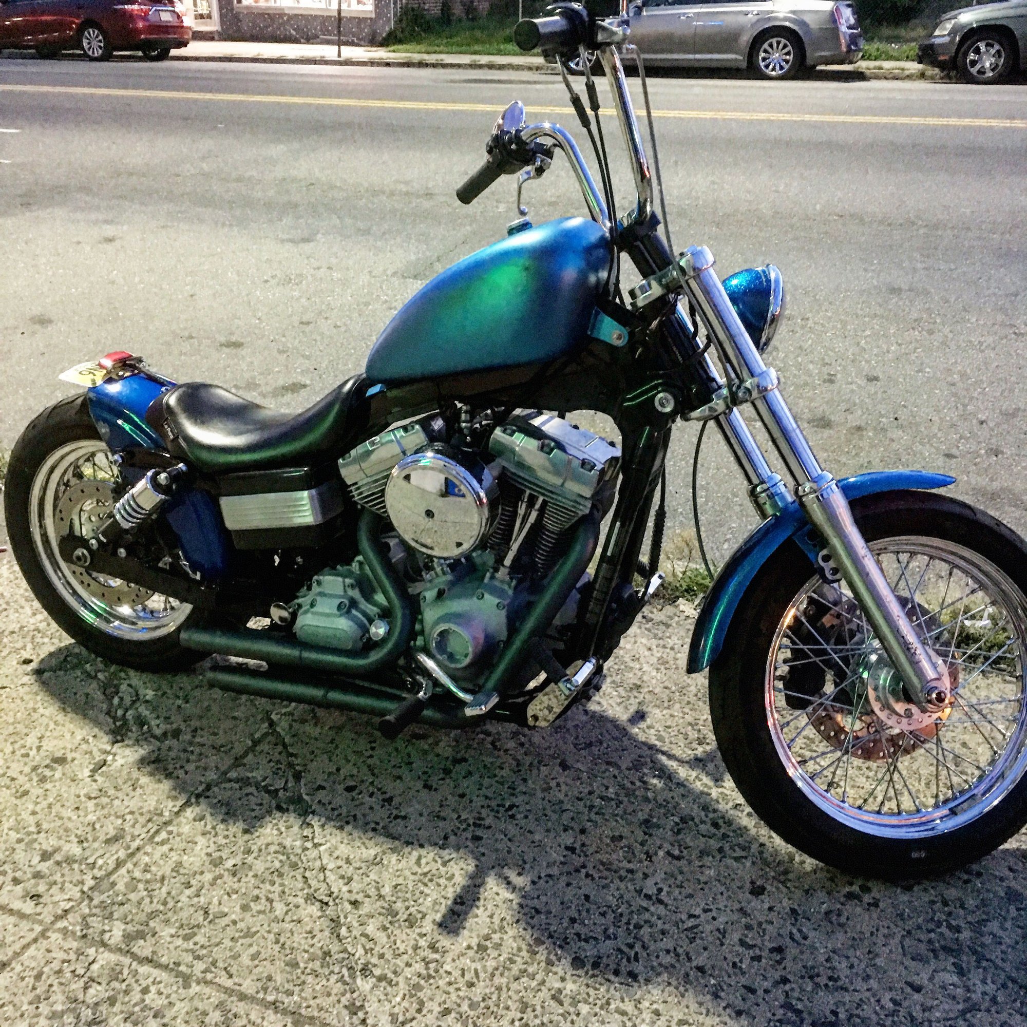

I did this 12 years ago. Not chopped, but a different Dyna look. EFI Frisco sportster tank worked great.
