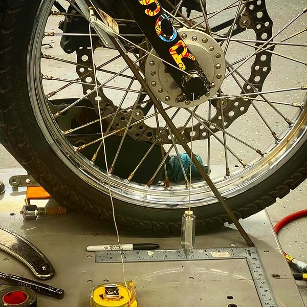

The rear fender I’m planning on using is now cut and on for a look see.
Here’s a look with the stock strut to show how much extra is cut from the red fender which is stock for the newer models.

From: Poolville
How thick is the modified strut and what would the weight load be? doesn't look like it would support a passenger..

From: mena, ar
its 1/4" and plenty strong for the purpose of the bike. The shape adds strength, especially when supported side to side.

From: mena, ar
I ended up at 5.25” trail with is close to what the fxlrst is, not to bad.

From: Poolville
5 1/2" I would think would be the best of both worlds, Stability at speed and Canyon carving... Nice..
I went to a set of Softail Deuce triple trees with an inch more of offset and 2" over on the tubes, more like a Softail Custom setup now and the rake is at 5.11".. Major difference... Love it..
