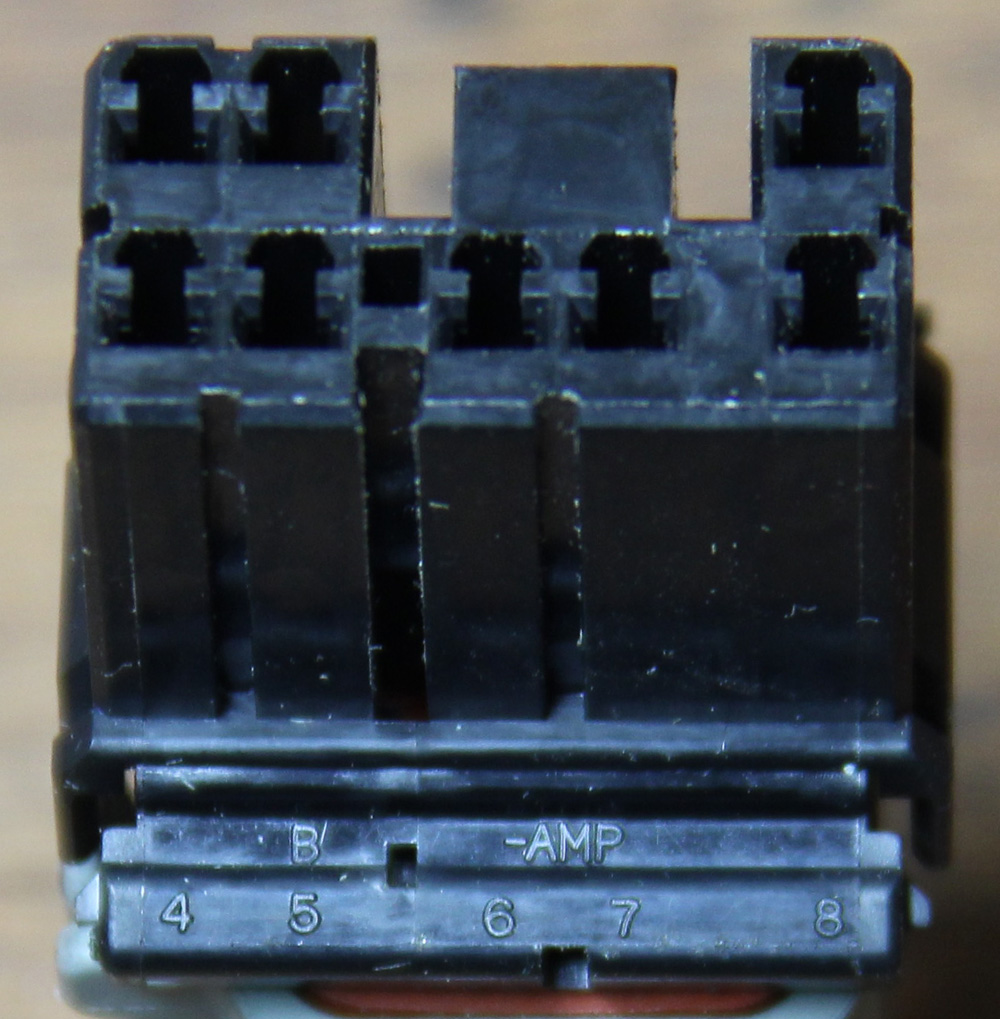

I am doing a little project on my lowrider I am putting a wide glide dash on it and I need help with the wiring, if someone could tell me what color wires go in the diagram I made up I would really appreciate it Thanks alot
numbers should be on the housing.
like the 6 holer below on the right..................

Mud you nailed it I got a magnifie glas and found the numbers and I never would have got right because the numbers go left to right and then you turn the connector over and they go from left to right again, I just wanted to say thanks alot this would have stumped me for a long time,
good deal roofer.
.....amp.. molex.. deutsch...... all of the connectors are numbered.
here are some better pix.............

Originally Posted by mud
good deal roofer.
Those are some great close ups!
