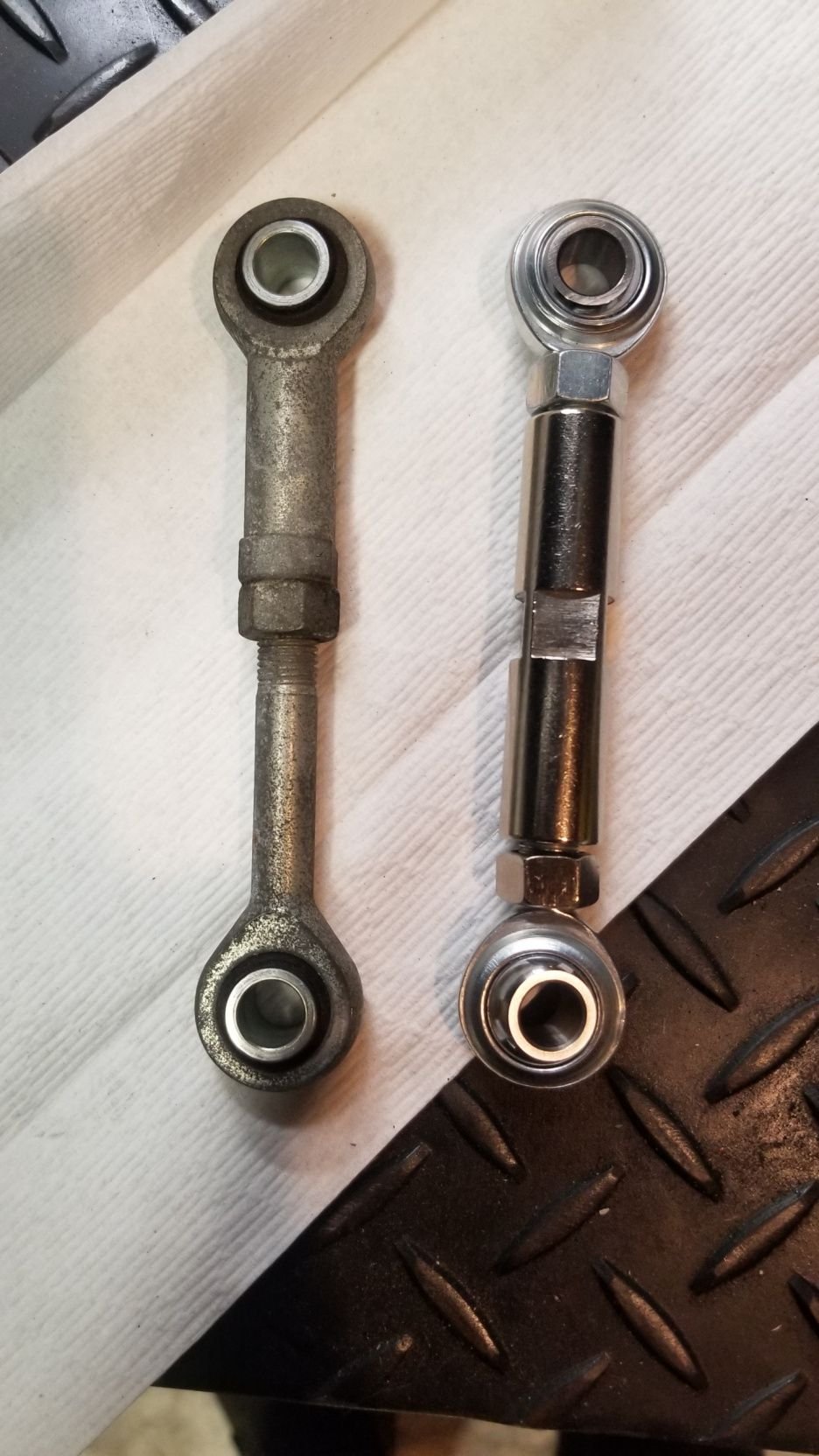

Remove the link, adjust length 1/2 turn at a time, replace link. Repeat as required.
Sputhe top link or eBay SBC alternator adjuster are better alternatives, tho.

I can’t find good examples of either of those two alternatives. Sputhe DTS only returns a single line on their price list. Nothing else. SBC alternator adjuster on eBay returns small block Chevy alternators and a couple 2.5” heim links they look no different from the Harley top link.
Do you have any links?

I would NOT recommend the CCE top link. It basically does the opposite of what most people want... It allows a lot of movement up top. It's designed purely to control vibration, NOT to maintain correct alignment. I used one for three or four months. I won't use it again.
I used this 2.5" Chevy unit initially: https://www.ebay.com/itm/2-1-2-Adjus...72.m2749.l2649
It worked fine, but I ended up upgrading the ends later (based on input from Chris). This one worked fine out of the box (envelope?), but it got squeaky regularly. A periodic shot of chain wax worked pretty well. With the new ends (from Midwest Controls, I think) I still keep them lubed, but the lube seems to last a lot longer now.
Thanks Tarik, I’ll check it out.
See, my problem is i overthink things. I'm sure this works great, but how does it adjust? I see a threaded barrel with a flat to get a wrench on. You still have to remove one of the heim joint bolts, right? Otherwise turning the barrel will simply move it higher on one side, and simultaneously lower on the other, right?
In essence the same as you have to do with the stock link. If so, what does this buy you?
