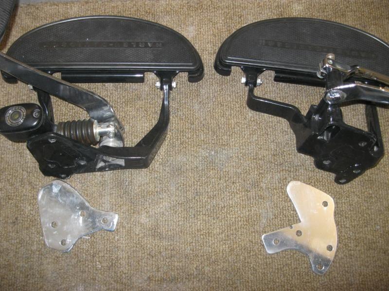

Stay away from the Wyatt kit or the very expensive eBay FXDP take offs, they sit your feet very high. The Switchback kit is a direct bolt on and a much better ergonomic solution. Full size foot boards give a lot of grip to your boots allowing you to relax your legs, your feet will not be blown off the boards.
I did mine before the Switchback was released, using Twin Cam era FL Softail assemblies with homemade adapter plate. They are further forward than the Switchback setup and are perfect for me (6'3").
