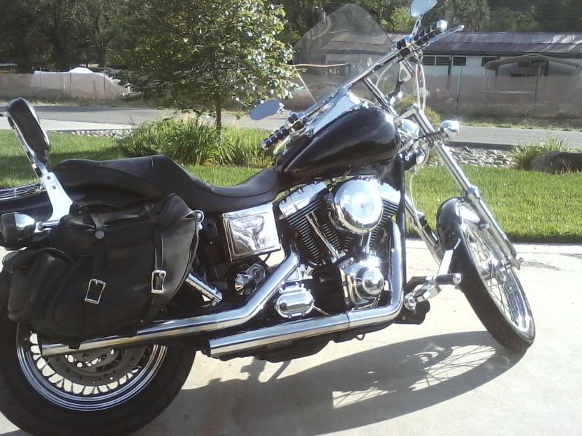

I want one so bad. I have V&H now and they are Ok. I am hoping they come out with a X series like the touring that has a full heat shield. I hate the 3 piece they have now but love the look and sound. My friend has a softail Standard the same year as mine with the same cam upgrade and he really pulls on me.
