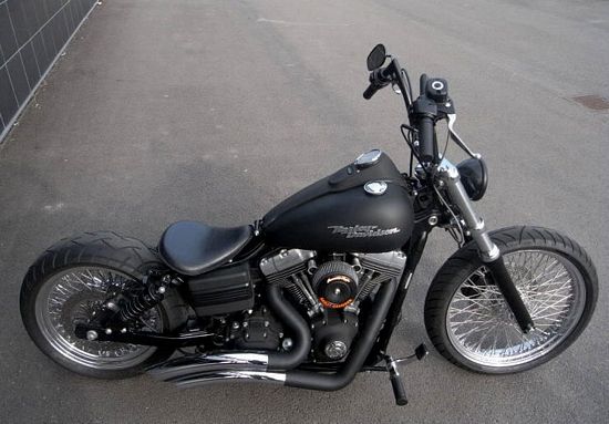

Looking to convert to a solo, bobber style seat on my 07 street bob. Im not a fan of the big gap with visible springs on most of the available bolt on kits.. anyone have any kit suggestions? I'm going for this look

If you know a welder or steel worker you could ask him (or do it yourself) to make a hidden bracket or aluminium or stainless steel. Or you could velcro it... If it has a large enough surface and it stil fits in the front of the seat so it snaps underneath like the stock seat i actually think velcro would work with some strong glue.. But a bolt on bracket is number one solution

If you remove the rear fender like on the picture you could make the bracket vith some holes that fit the plate on the frame underneath the seat... It has several holes if i remember correct. Then the plate should have a small bend towards the rear end of the seat and a hole so you can put a bolt thru the bracket and up in the seat that you normally use for the mounting hardware.

I was just thinking if it was held in place by the stock front bracket.. And then if the velcro is good quality and a big enough area it can actually be quite hard to "rip it off" but i agree that doing a bracket is much better/safer, and is a easy fix. I could make you one in an hour or two if i had the bike and seat near to meassure.. You must know someone if you are not up to it yourself

Thanks for the suggestions. I guess I'll have to buy the seat I want and just make up a bracket to fit. I can't go with a lepara as I'm ditching the rear fender and that's where it's mounted. I'd like something a little smaller as well

are you planning on cutting off the struts as pictured?

Most Dyna seats are going to want to use the rear fender to mount...that is where the metal bracket would come into play.
I would unbolt the rear tab and use the tab mounting holes to bolt it down onto a custom bracket...that way no tab sticking out the back.
