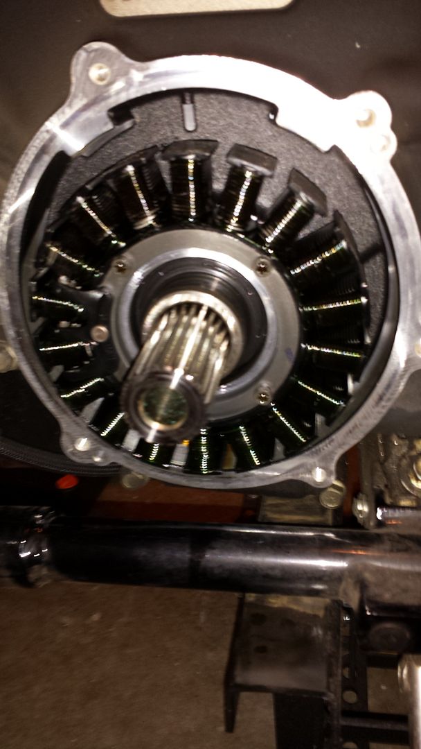

My stock stator's insulation was questionable when I had the bike apart at 20k:
The Cycle Electric stator additionally has a higher temperature resistance which should keep it looking like this:
The 2A difference probably won't be noticed, at least for me. It was more for durability in my case.
