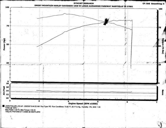

Here are the numbers from my first round of mods...88 to 95 cu in, high compression pistons, 211 cams, high flow intake, screaming eagle torque mufflers, exhaust, and screaming eagle race tuner. 85hp 92torque...no head work.
