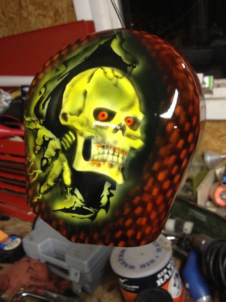

use a DA sander with 1200 paper and sand surface well, use self etching primer and good quality paint and will have no problem . I have my timing cover,derby cover painted with air brush paint and than cleared coated have been on bike sense this spring and have had no issues paint looks as good as day they went on.

First of all thanks for the input, thats what i'll try. second, that is some pretty awesome artwork!

Nice work on that cover it looks cool.
