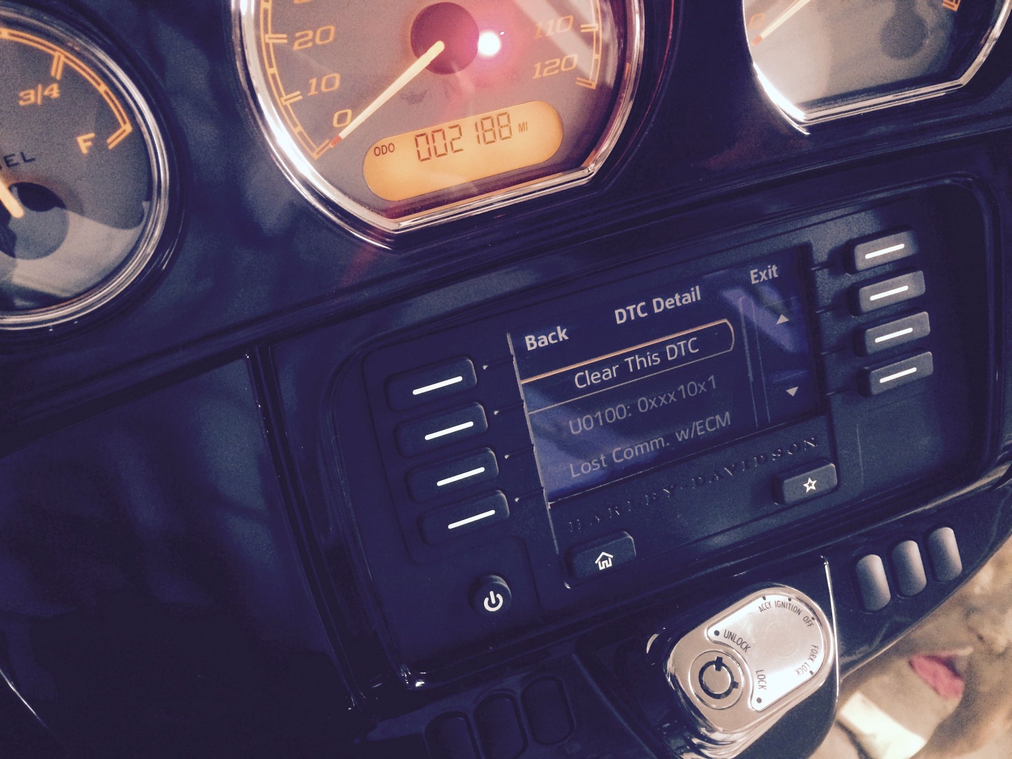

Installed 12" Yaffe Monkey Bars. I carefully taped all connections and wrapped all wires in an abrasion resistant cable wire sleeve.
Just put the tank back on and was attempting to start the bike and i get nothing. I can hear the fuel pump kick on.
All the switches on the left side of the motorcycle work. All the switches on the right side with the exception of the start button work (hazards work, info works, turn signal works, kill switch works - can hear fuel pump kick on when switching it back and forth).

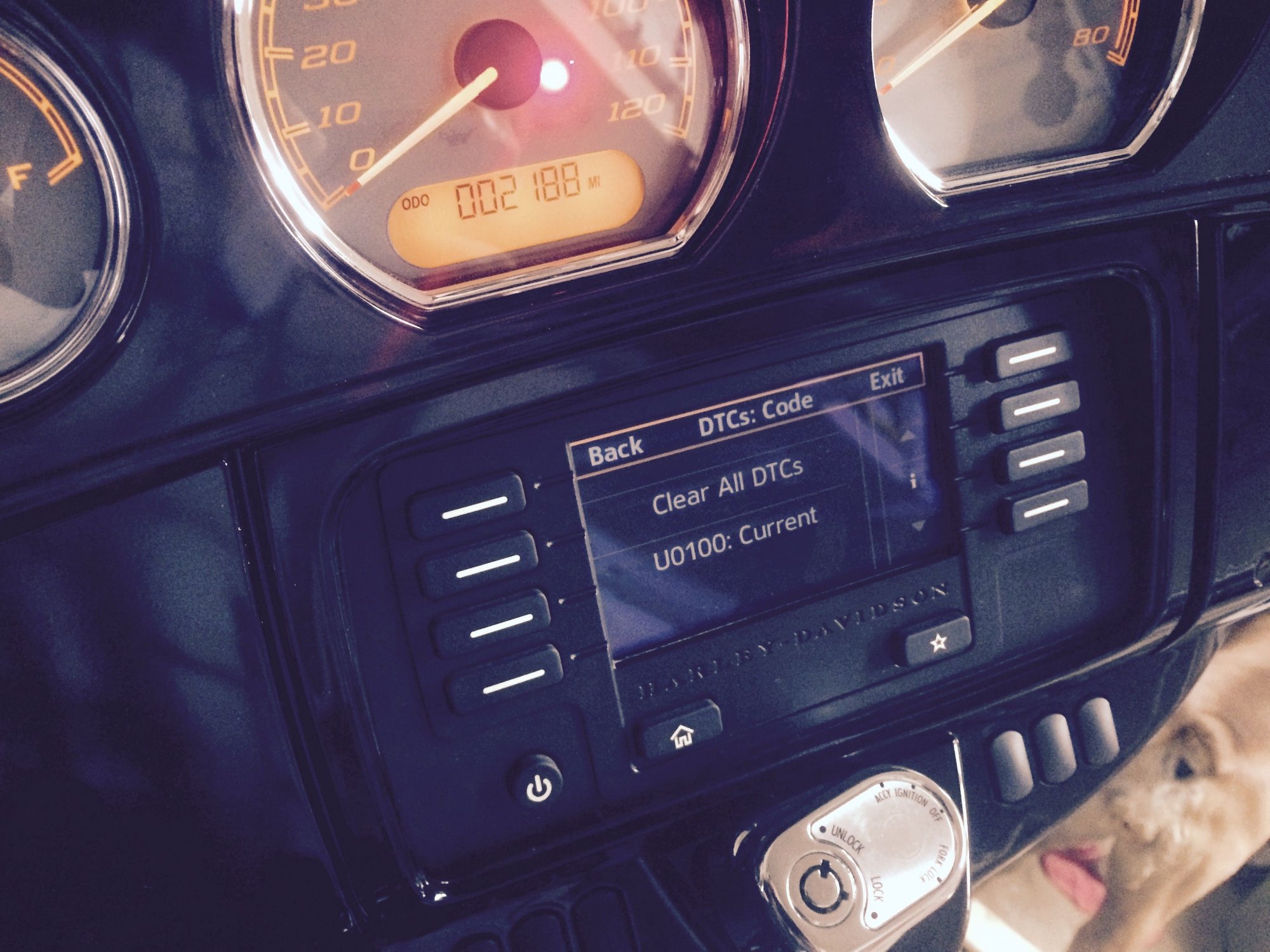

I have the solid red security light on. And when I look at the DTC's on the screen I get a U0100 Code that reads U0100: 0xxx10x1 Lost Comm. w/ECM
Any ideas what went wrong with the install???
