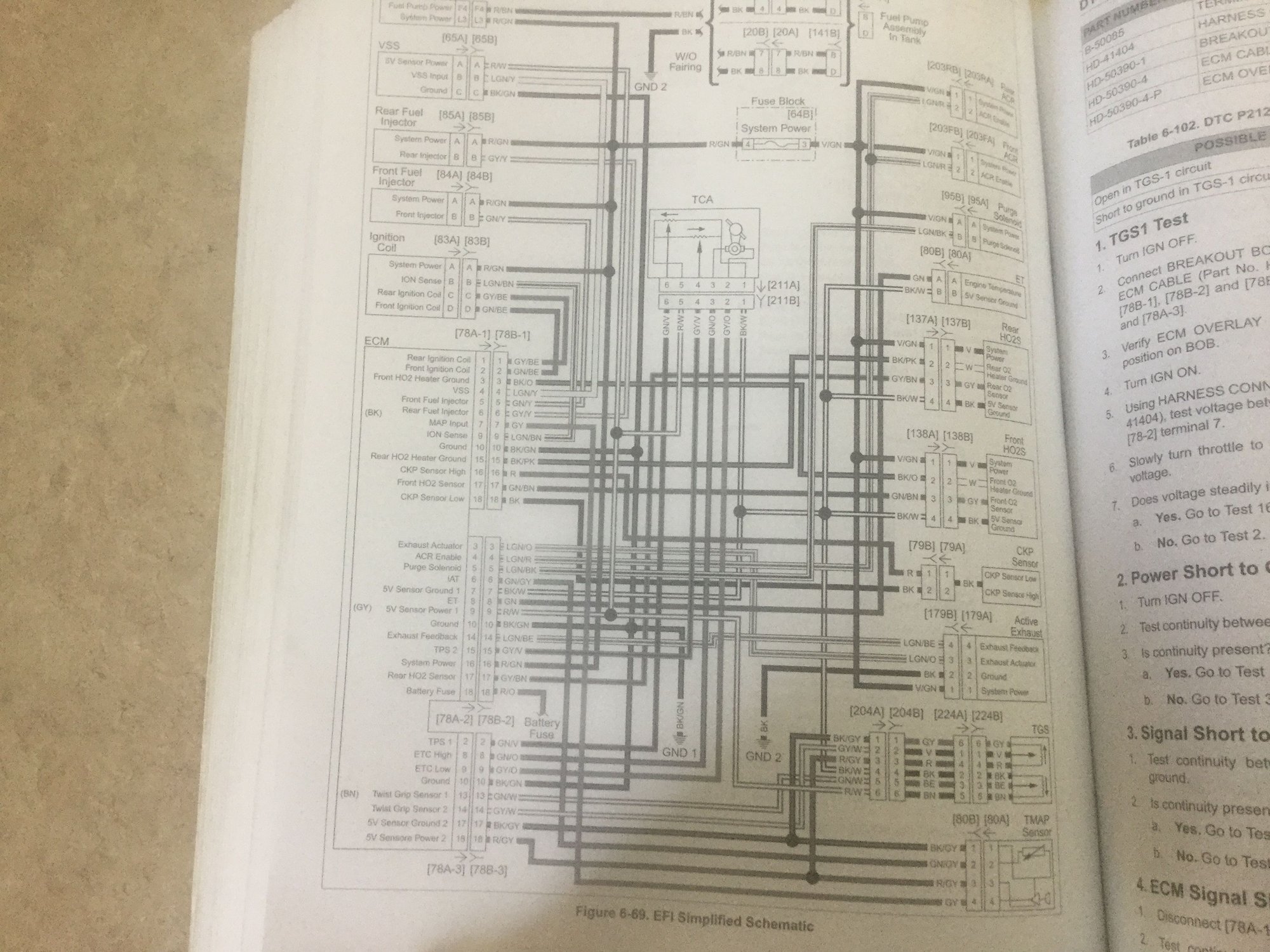

You can do most of it with out the Breakout box, just look at the schematic and find the wires.
You may be able to do the first check if you can slide the meter leads in the connector. If not the very sharp leads can make a pin ***** and cover with good elect. tape.
Test 9 might give a clue.
