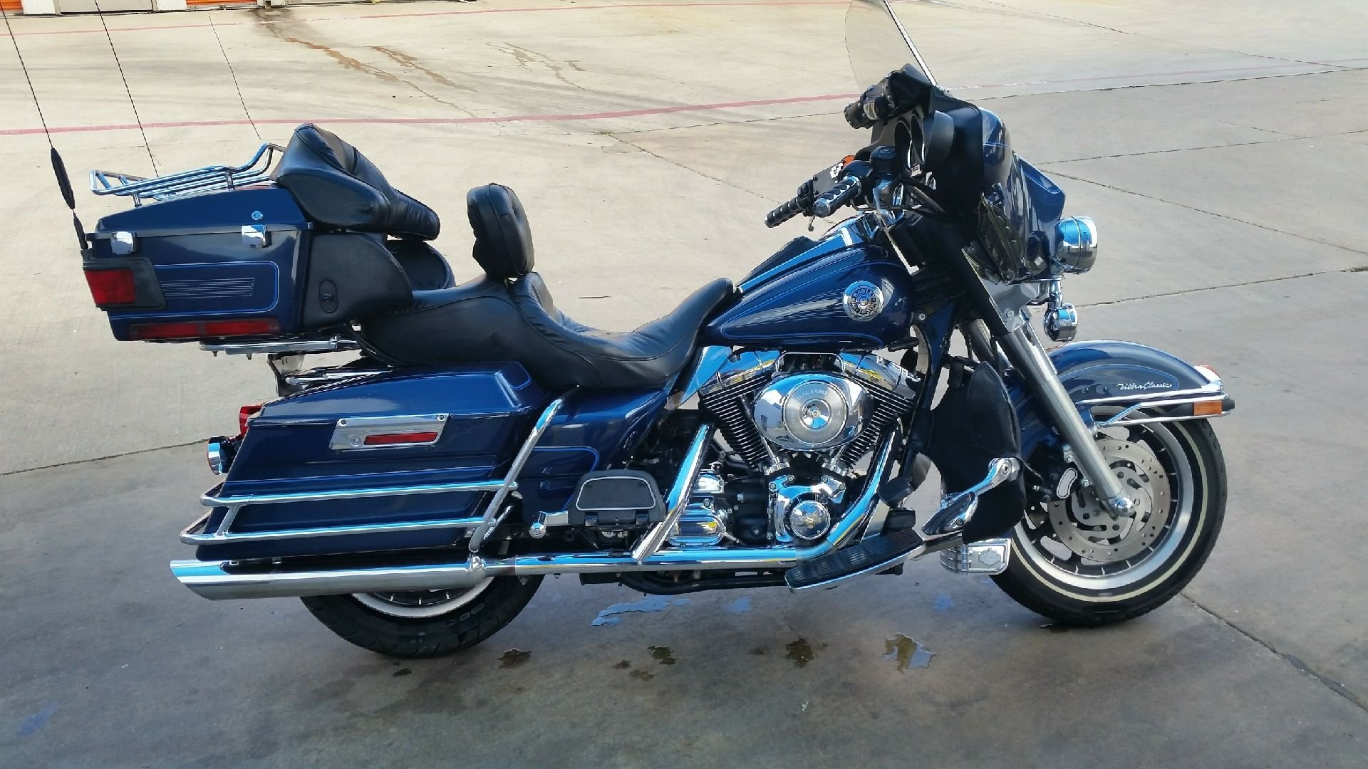

Long story but here we go... I'm on a 2000 Ultra, FLHTCUI-EFI, 63,000 mi. My stator quit charging, I tear into it, it's def burnt. I change stator and regulator, thought it was fixed charging 14.3V at the battery, rode it about 6 miles and the volt meter on bike shows it quit charging at about 9V. I continued to my destination... I exit, bike starts smoking and stalled. Smoking big time, so now I'm off it and the f#@&=ing regulator is on fire!! I got it put out but had to disconnect battery to kill all power. Get it home, stator seems ok as it's charging 24V@2000 RPM, 45V@2000 RPM, 80V@3000RPM. I changed regulator, it's charging fine at batt., checking reg temp while running and it's getting hot, so I put a fan on it and the temp stops rising. Now I test ride, 3.5 mins from the house my speedometer and odometer die, and volt meter maxes out at 16V on bike. It has done this several times as I've test ride a few times. Now on the highway at higher speeds and RPM it's worse!! I felt if it's charging 16 or more volts the battery is about to blow under my ***!! When I stop, take seat off battery is pretty hot but negative terminal and cable are very hot! I agree with a local HD tech who says I have a bad ground. I changed the first neg cable off batt to frame, tested out ok (so i thought) test ride and seemed better until it spiked again! Im baffled and i can't stand electrical issues!!! The bike is clean and well kept. I'd appreciate ant input if us can. Thanks folks!

And that's a great looking ride.

Thank you much. She better lookin when I'm on it and doing 75mph!!
