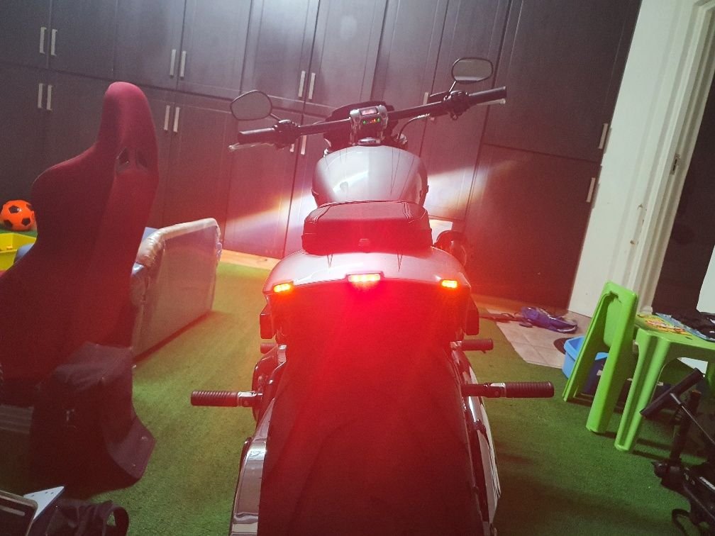

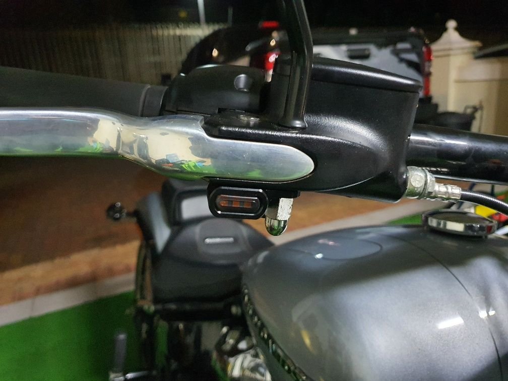

Hi Guys please provide some advise
2020 FXBRS
Front Led Indicators
Rear Indicators and Tail / Brake Combo
I installed a set of LED front Indicators, set of custom rear LED indicators, taillight and brake light.
The indicators are flashing normal speed, the dash indicator is flashing at hyper speed (so to speak) and I'm getting an "Open" error code for all the indicators on the FP3, so I ordered a few load resistors, 10 Ohm 25W, my question is, do I need to install one load resistor on each of the LEDs (4)? or will 2 be sufficient i.e. 1 on the Left and 1 on the Right, I was considering under the tank where the front indicators plug in. ??
