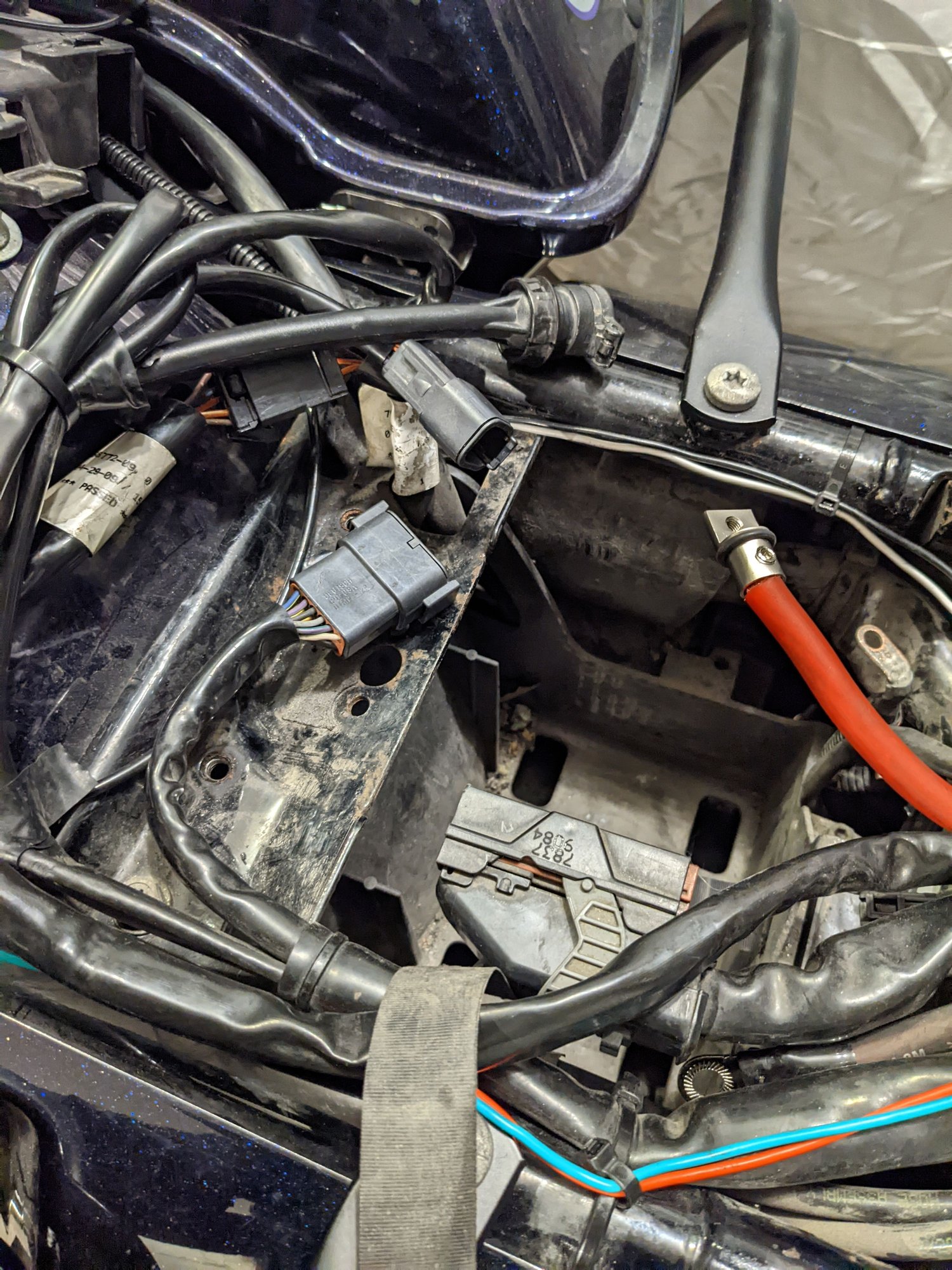

There is a harness connector under the seat that I am not seeing it's male end...no clue has anything to do with this.

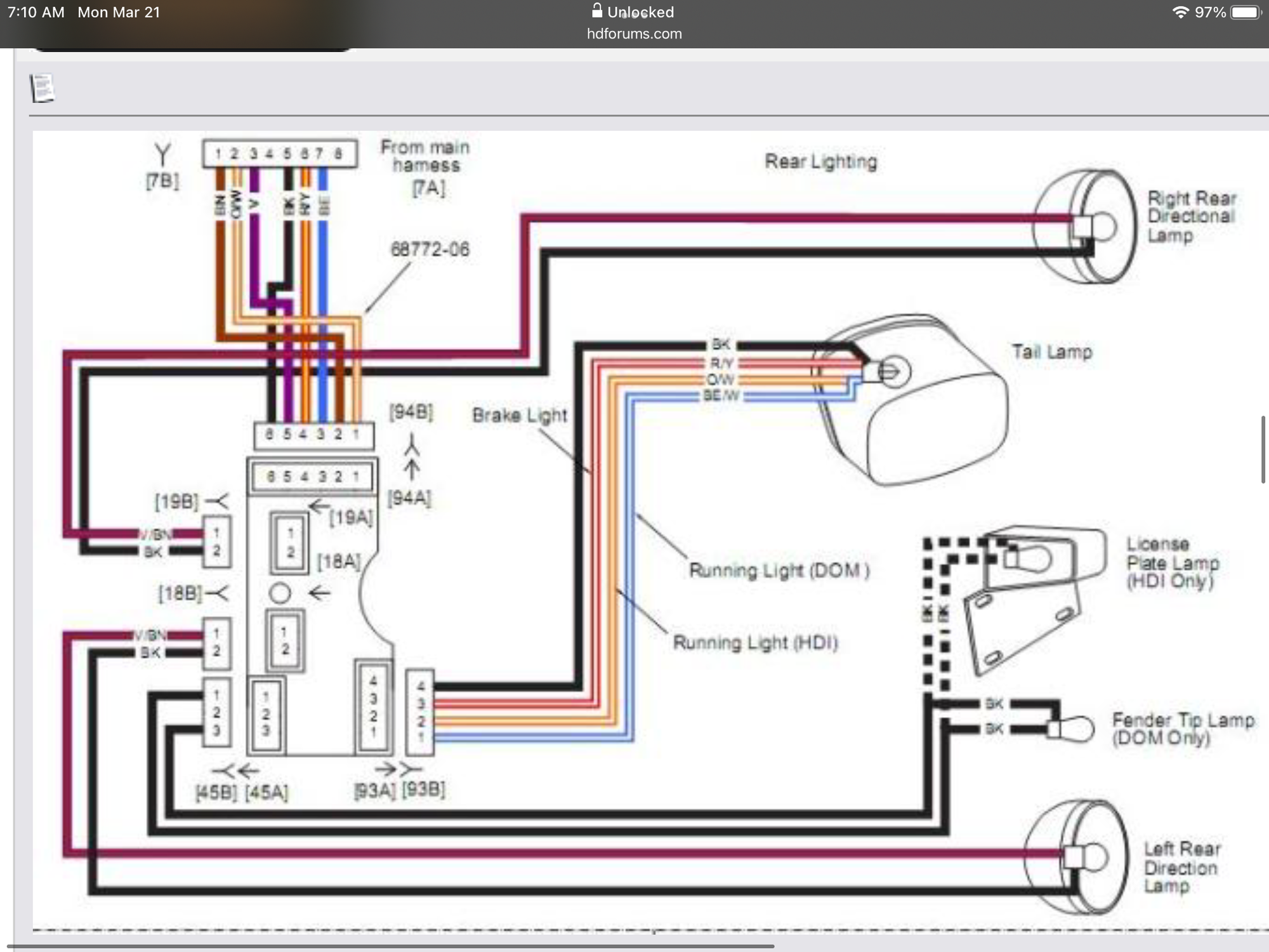

Since it's gone non OEM, is there a control that just uses the same LED for run and brake by just making it brighter?
Over the internet, things get totally confusing especially non OEM.
To answer you question, either wire on the hydraulic switch. But to test the actual switch, the one leading to the rear.
Use wire circuit above to break wire to check front one in clam shell but it pretty confusing. I 'm traveling, so dont have access. I just work with hydraulic one. Once its broken, and problem then points to front one bad.. Probably not both switches are bad.
