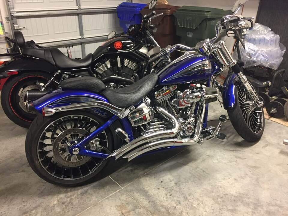

I have a 2014 CVO Breakout. I am gone for long periods of time so I keep it on a battery tender. She turns over but it takes a few seconds to get her to fire up. Runs fine once I start it. If I get off of it during a ride for a meal, a beer, a ****, anywhere from a few minutes to an hour or two, she fires right up, faster than when she's fresh off the tender. I had the battery bench tested and it's 100%. I'm trying to get it figured out why she struggles to start without a visit to the shop and before she leaves me stranded. Anyone had similar issues or suggestions? Thanks in advance for anything you can offer on the subject.
