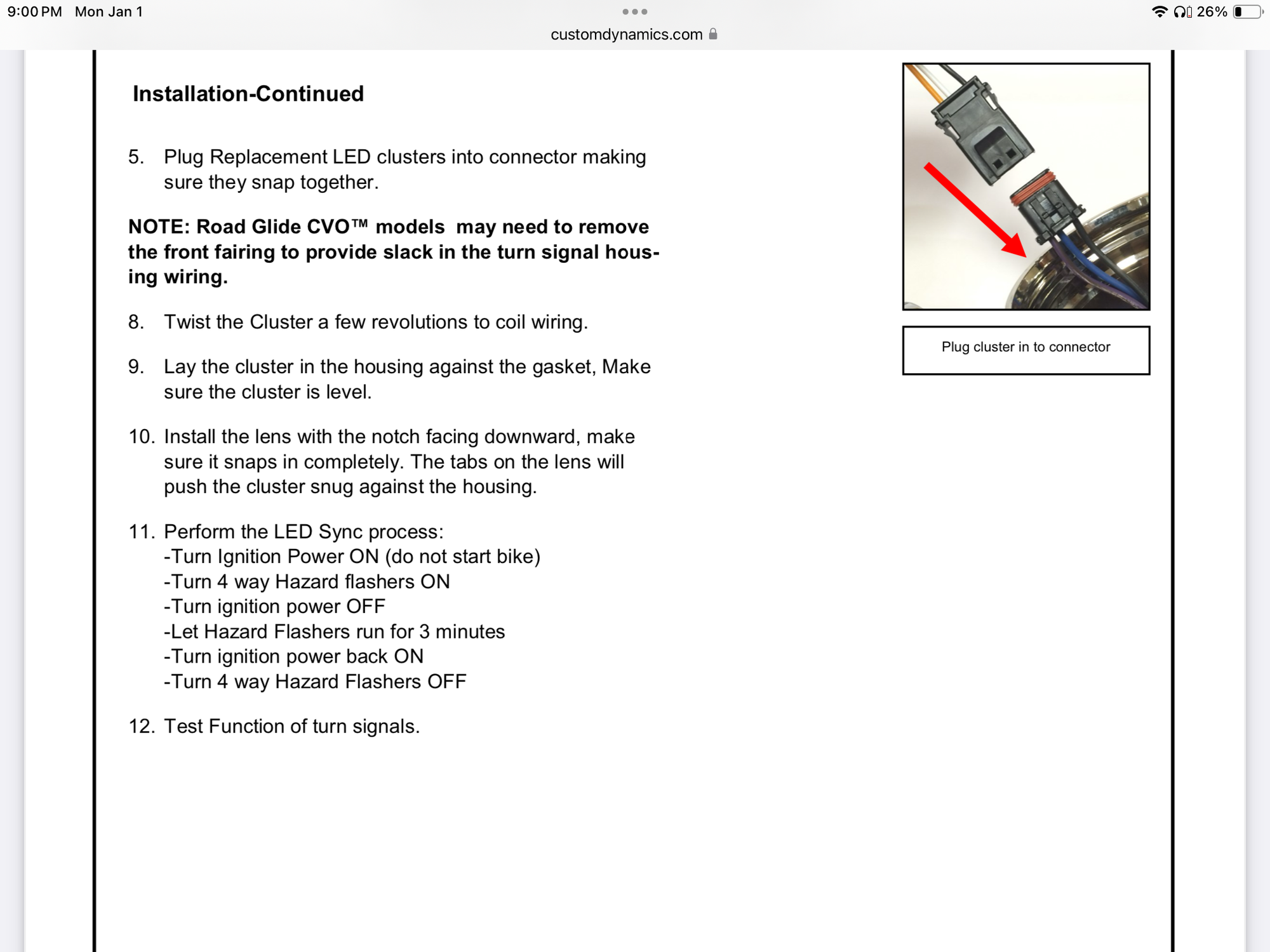

Old Jan 1, 2024 | 10:06 PM
Vernal's Avatar
Vernal
Joined: Apr 2013
Posts: 7,681
Likes: 8,413
From: Utah
@1redrider Try the things posted below. If you can’t get it sorted out call Custom Dynamics, they can help you.
https://support.customdynamics.com/h...20flash%20rate.
