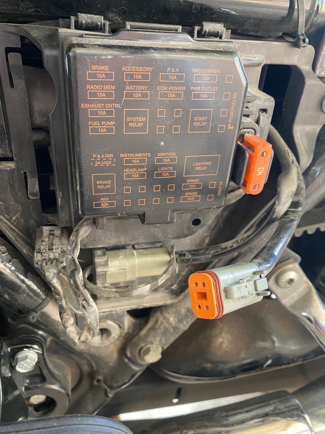

Default ABS Diode Missing?
After looking at another post about brake lights having the same issue as mine, I noticed in the picture that I might not have an ABS diode attached. Take a look at this picture and tell me if I’m missing that part and that’s probably my problem.
It the connector hanging in the air. This little connector was tucked up behind the master fuse.

That appears to be the connection when you flash a tune with a device like a power vision...

Correction!!! See the grey plug right beneath the fuses , that is your connection for your tuner. Sorry about the wrong info.
