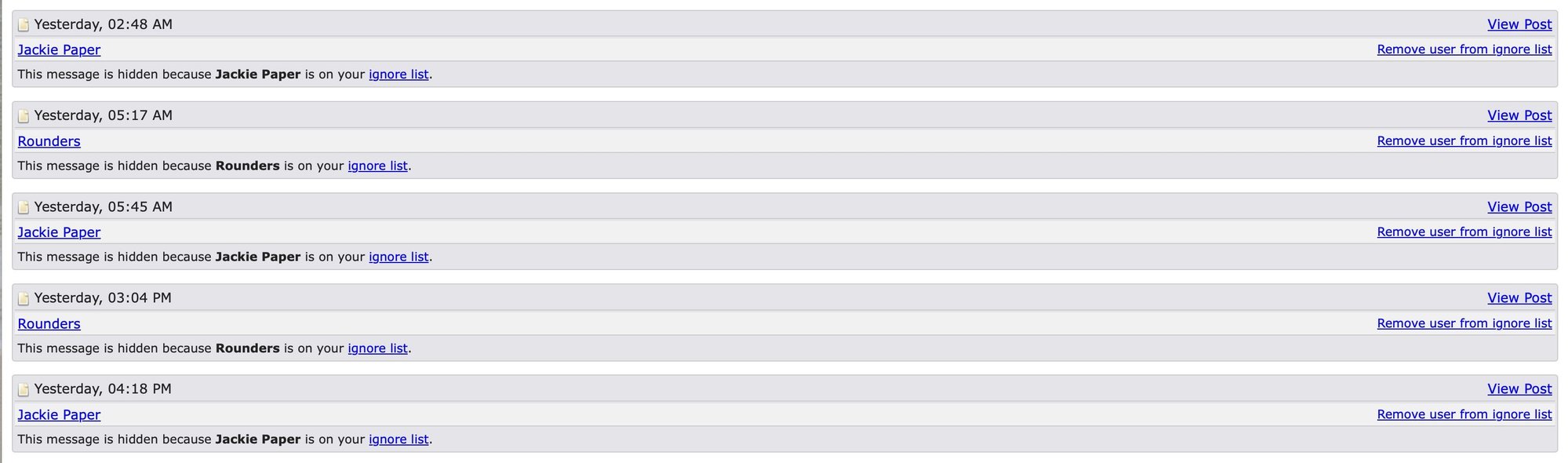

Now you guys did it...
Old Feb 11, 2025 | 07:42 AM
702's Avatar
702
Joined: May 2018
Posts: 5,814
Likes: 7,145
From: Las Vegas
Not at all. It's a sincere effort to show the new guy how to avoid bad advice. He may not know that this feature is available.
