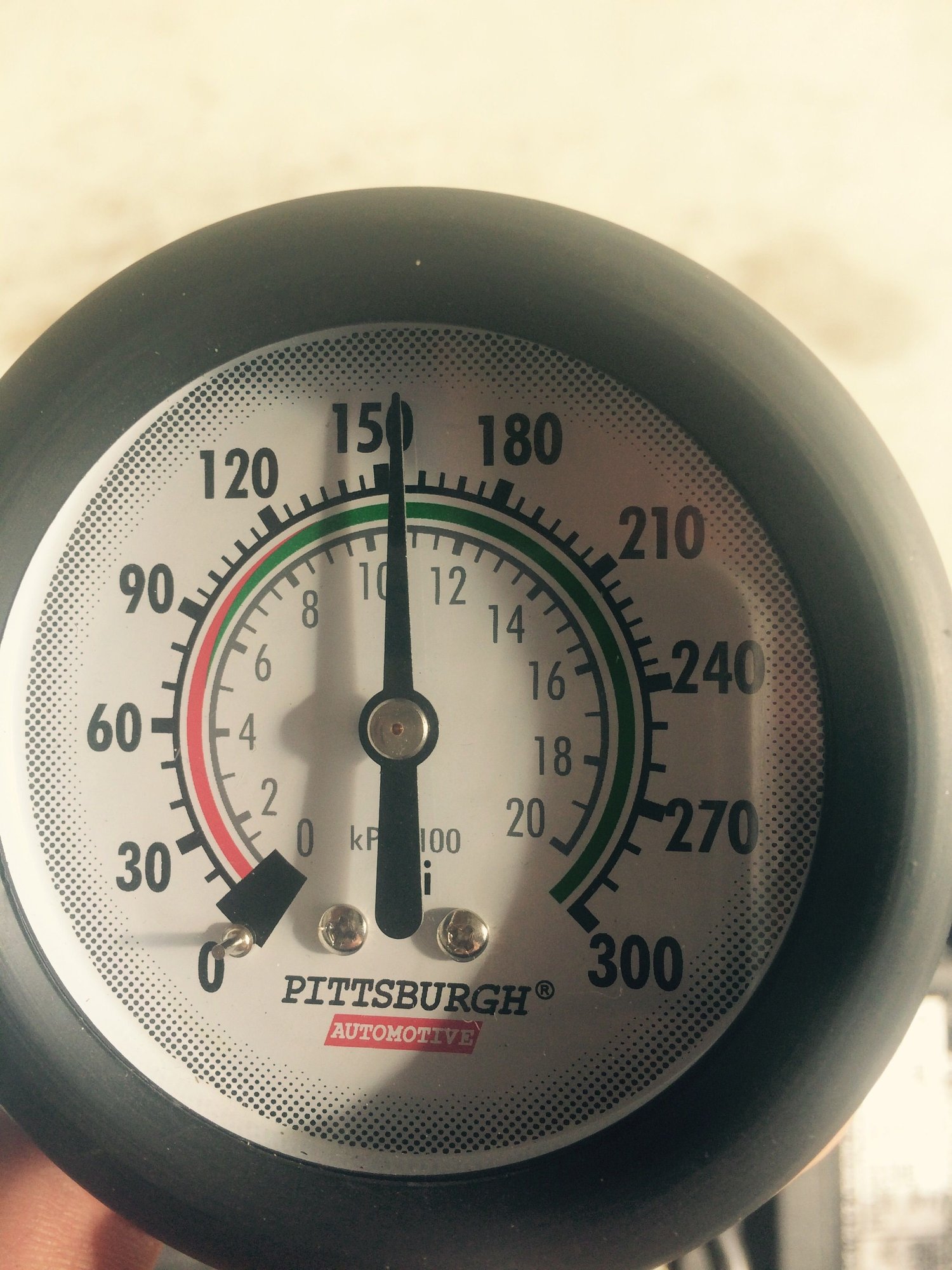

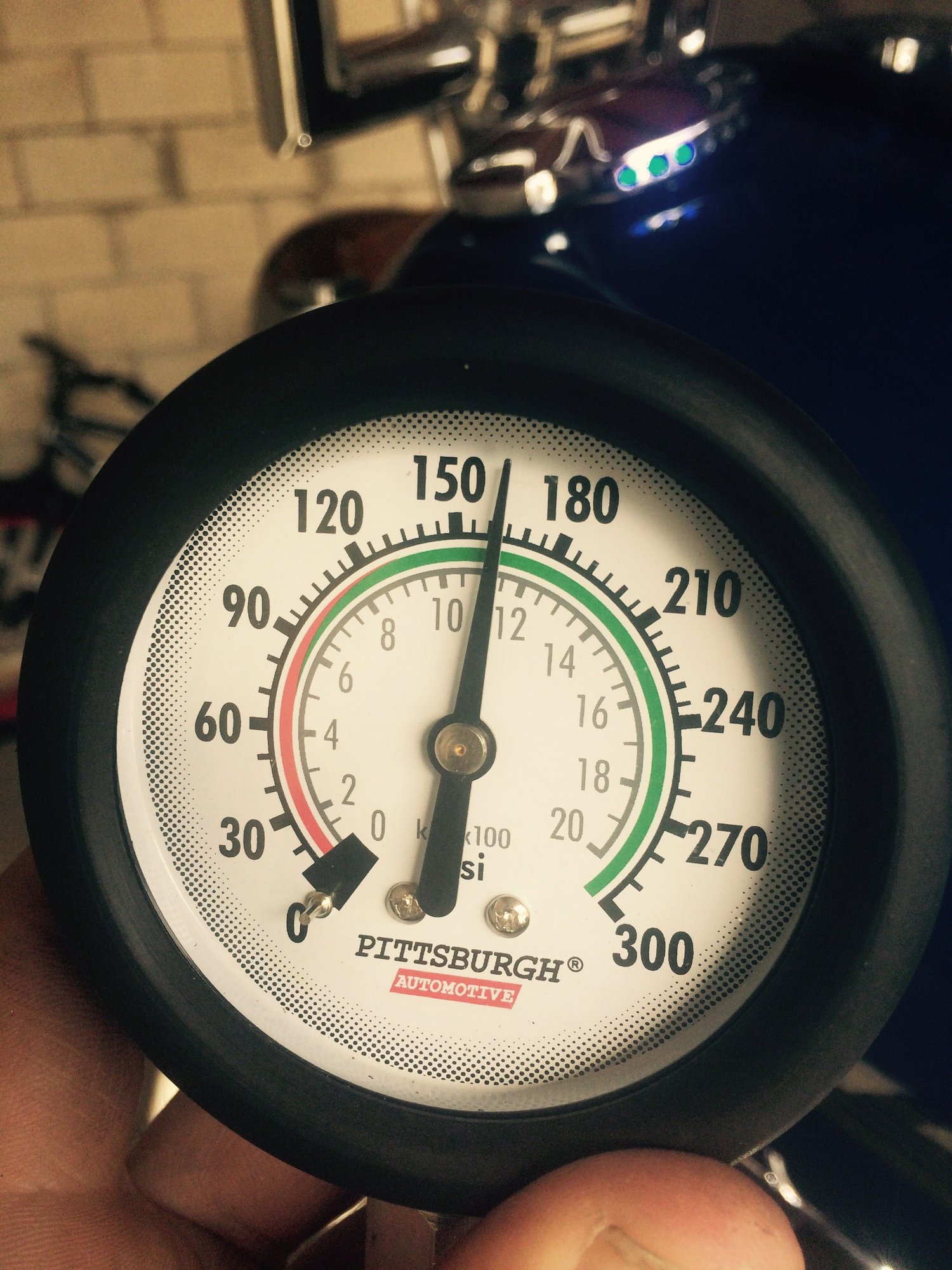

Well, I'm a bit surprised by the compression test results. You said you expected around 200, I didn't get near that. The rear cylinder came in at ~152, the front came in at ~163. This is with both plugs pulled, fuel pump fuse pulled, cold, and throttle wide open for 8 plus cranks. Does that make you think cam timing? I don't think I will be able to get at the cam before this deployment, it may have to wait two weeks.....
Rear
Front

The cam will not take away from your effective compression however it's very possible that those flat tops are 9:1 and if the heads you got with the kit are the 89 cc heads then your ccp will be right about where it is, You need to get all the specs on all your parts and put them into a calculator to see where you should be. Contact the people that put it together, get all the part numbers and research the specs.
IIRC, your S&S cams are Easy Starts? If so, that would account for the low CCP. At sea level, your CCP, according to my calculator should be right at 200psi with 89cc heads, flat top pistons, OEM head gasket and 583 cams. The EZ start cams bleed off 20%-30% of CCP, which would mean the your actual CCP would be somewhere 185-195/rear and 195-210/front. The 10psi difference does not indicate that cam timing is off so, it doesn't appear to me that cam timing is the issue, unless the cams are not EZ start.
Can't do a compression test but can do a leak down test which is a better indicator of top end condition anyway. However, as I said, if cams are EZ start, no need to go there.
very good point. Forgot about that feature in the e-z start cams... They're working obviously...
The cams are ez start. So, I guess I'm still looking for the smoking gun. That noise I hear is bothering me more all the time, wondering if it isn't the cam plate. Won't know for two weeks or so. Still have to check that and the lifters......
