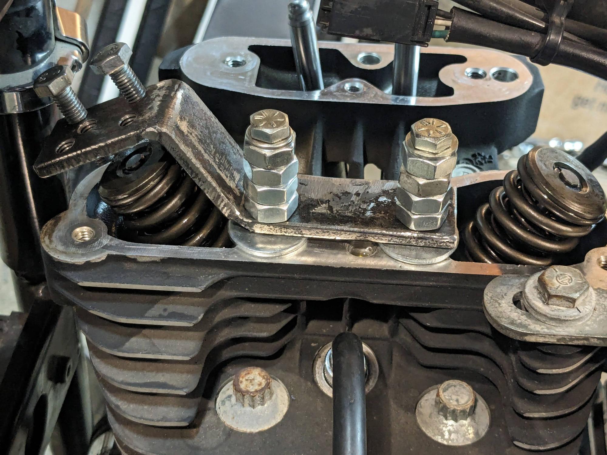

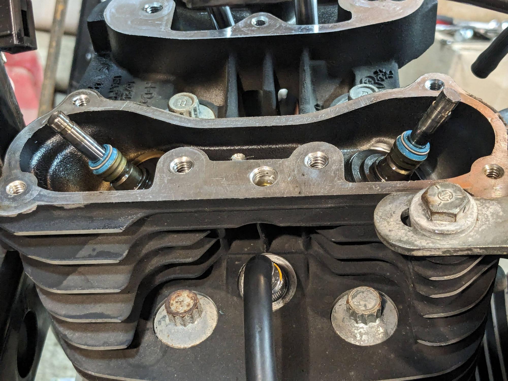

Old May 19, 2024 | 11:38 AM
giganpv's Avatar
giganpv
Joined: May 2016
Posts: 72
Likes: 16
From: San Jose, Tomsk
I just replaced the valve seal without removing the head. For this I made a simple tool.
