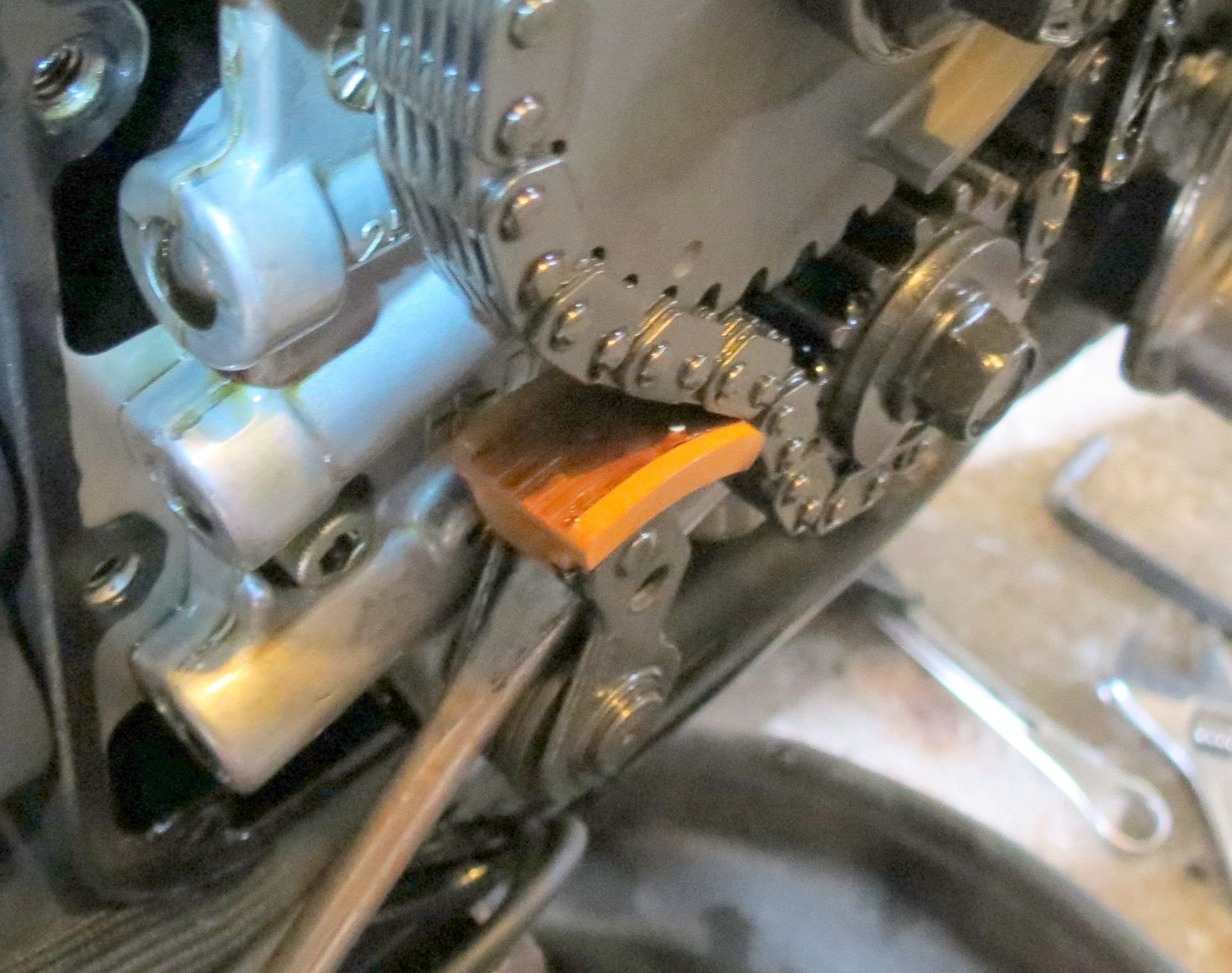

Originally Posted by joebedford
Here are a couple of pix of the cam tensioners on my 2002 FLHTCUI with about 25,000 miles (bike was new to me last year).
There's some wear and one or two small pits.
I don't think they're in need of replacement. Opinions?
Inner cam tensioner
outer cam tensioner
That's about what my 02 Fatboy looks like with same mileage. My buddy got 60,000 out of his 02 Heritage before changing and they were still a little more than half worn. Not to worried about inner bearings as 2002 was the last year with Timkin bearings. I'll check mine again at 35,000 miles. Btw, I've only heard heavily worn tensioners exploding. Please show examples if you know otherwise. Tia
Timken are the crank bearings and have nothing to do with inner cam bearings. Check out the two photos; one with about 12K miles and one with about 24K miles. I am sure you can find and post photos of tensioners that look good with more miles as there are thousands of early models running around without tensioner issues. But who wants to be the one out of ten that has to rebuild a motor because a tensioner comes apart?? **** happens, just hope it doesn't happen to you or, replace the shitty tensioners and make sure it doesn't. Why do you think the MoCo changed to hydraulic pressure instead of the heavy spring pressure and to a different material that was not affected by heat and exposure to oil???
My bad on Timkin bearings.....but generally, bearing issues didn't really start showing up until 2003 (and later) models were in the marketplace. As for exploding tensioners......I've talked to many owners of 2000-2006 twin cams and it seems the tensioners either wear out early around 12,000 miles, or they last for 40,000-60,000 miles. Me thinks it depends the dies used to cut the chain. If the dies are dull the chain will have sharp burrs that quickly eat up plastic tensioners. IMO, its a great idea to inspect them at least every 10,000 miles. JMHO
Actually, TC88 motors had outer cam bearing issues from the jump. 2% failure rate on the rear ball bearing in the '99 and into the '00 production year. The rear ball bearing was a running change in the middle of the 2000 production year. The INA inner cam bearing has always been an issue and when they go, usually the only fix is a reman motor or pull the motor, split the cases and make the necessary repairs. As for the tensioner, does it really matter whether the dies used to cut the chain, the wrong tensioner material or the heavy and constant spring pressure causes the early tensioner to fail? Point is they can and do fail and it is a gamble to run them. Why run the risk? Sure, checking them every 10K miles sounds like a great idea until the tensioners fail 2K miles after they have been checked.
The potential problem can be eliminated in a couple of hours for less than $100? Easy fix, particularly if one is in the cam chest anyway as the OP is; half way there. Or maybe some prefer to "live on the edge" and take their chances when a $5000 repair could be the result of the gamble. Just doesn't make sense to me.....
