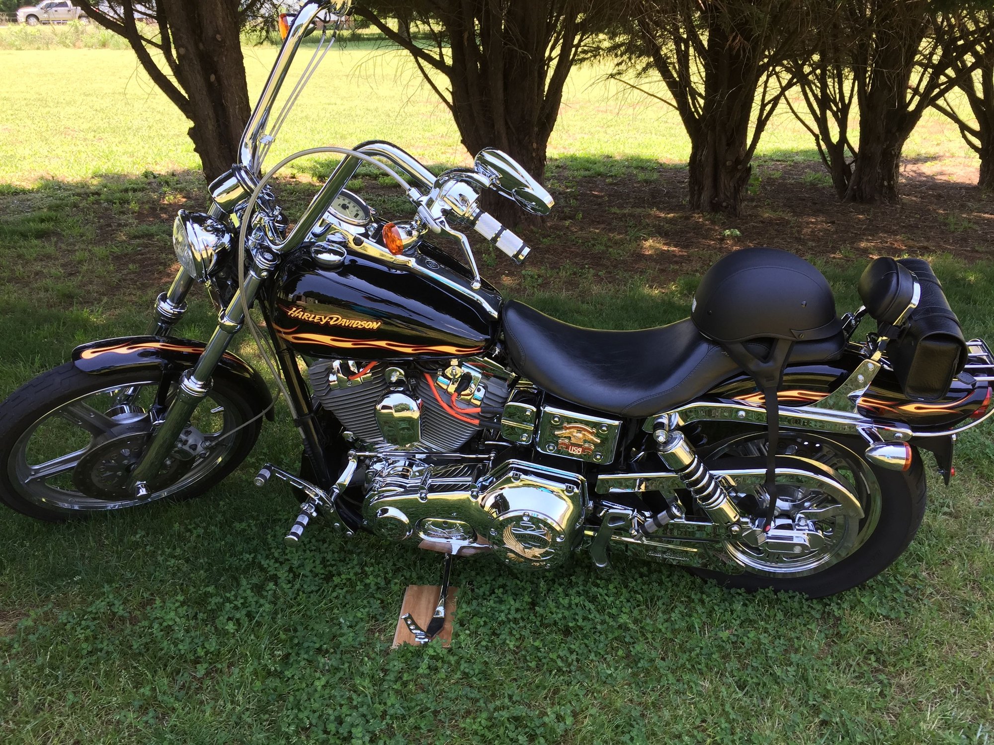

Default What should I do? What would you do?
I have a 2002 FXDWG3 CVO with 34,000 miles on it and am pretty sure there are still spring cam chain tensioners on it. I bought it from my brother and he doesn't know if they have been checked or upgraded because he was the 2nd owner. He also just rode it and is not mechanically inclined. After reading about hydraulic and gear upgrades I don't know which upgrade is best for me. I can tell you this, I am afraid to open the cam chest to even look at this point. First Harley I ever owned but motorcycles are not new to me. This is very discouraging to know this problem with Harley Big twins. I love my bike and want to take care of it but funds are low after I purchased it. Should I just park it and wax it and not ride it anymore ??Help!
