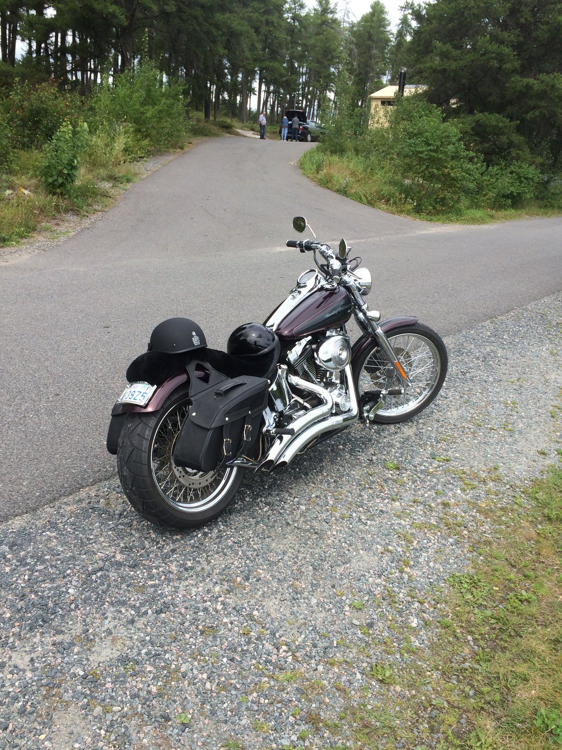

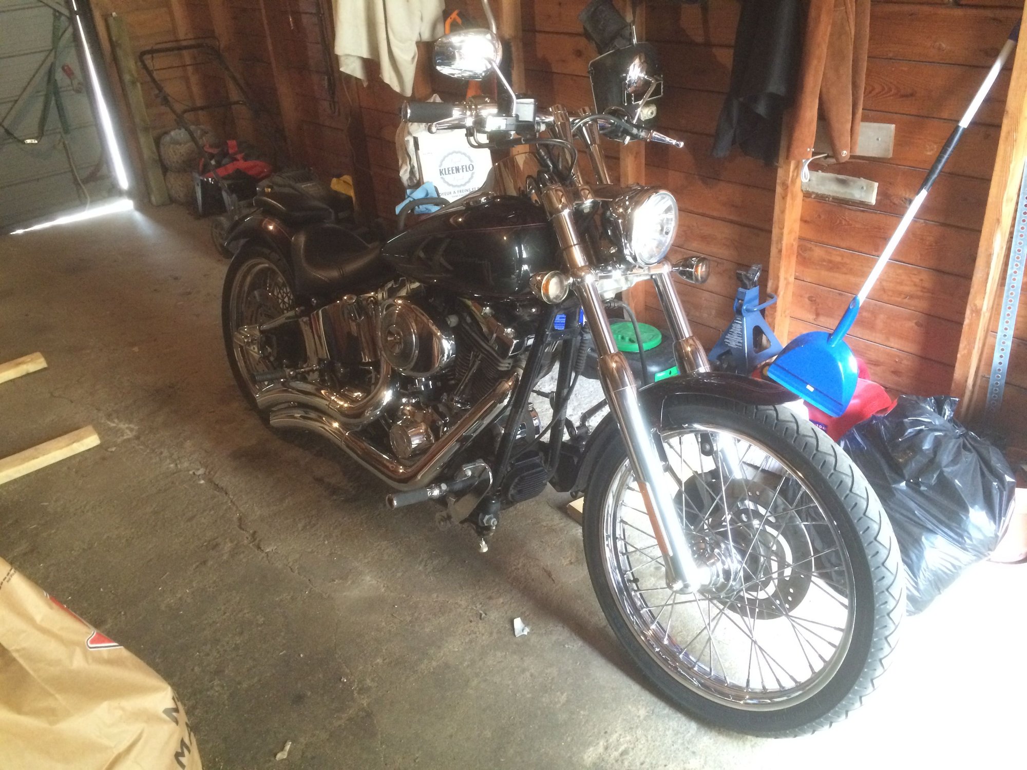

Here's some pictures of my Deuce right now. Maybe you'll see what I mean about upgrading a seat and getting better saddlebags to take some longer trips. I'll be honest it's giving me a headache trying to decide what to do haha!

I set up the Deuce for long trips with the HD luggage rack to which I attached a Tourmaster Tall Bag that sat on the passenger pillon and a small duffle that sat on the small luggage rack and a tool bag strapped to the Ness Lo Fly bars with more rise and pull back and I do run with the quick demountable windshield just in case I hit some rain and I always hit some rain. Also extended the foot pegs 3" and added a set of Kury long ride pegs that let me change leg position from time to time. Much more comfortable than stock but not near as comfortable as the old FL. The seat is a Mustang Vintage Solo with the wide passenger pillon. The wife doesn't make long trips but sometime accompanies me on weekend outings and swears she prefers the Mustang passenger pillon on the Deuce to the Mustang passenger pillon on the FLHT; I don't get it but it her butt.
In all honesty, if I were to do it all over again, I would have bought a Fatboy instead of the Deuce. It can be outfitted with quick release bags, demountable luggage rack and windshield like the Heritage softail and all that can be stripped off for in town profiling if one is into that. Having said that, lots of bar hopping can be done on a Streetglide; very cool profile even with bags and bat wing. Let me know if you go with the winter build. A couple of years back, I helped a guy in Canada with his 95" build; HD won't ship parts internationally so in addition to helping with the build plan, I purchased parts and sent them to him.
