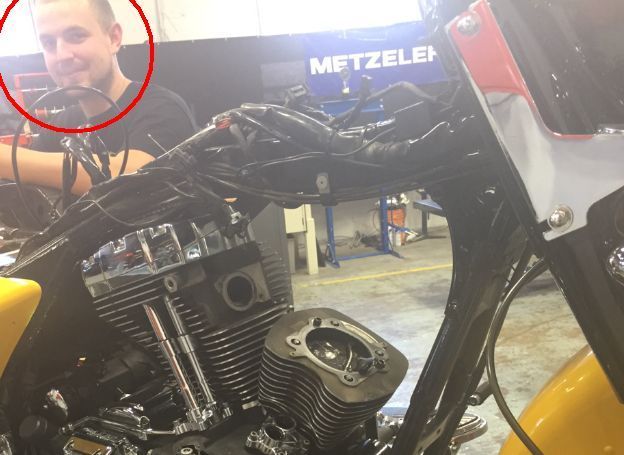

Originally Posted by ChopinRockwooD
What would you do? Put another 6-10 grand into the engine and sell it or keep it. That would be app. 20 grand since May.
Or sell it as is with blown motor.??...
Just a couple comments...
Really you are asking "What would you do if you were me?"... because we all have different resources and skills
And more importantly... I would talk to the Mgr about this guy's smirk

Just got back from checking out the motor. I had a tear in my eye. She's Fu(k'd all right. There were 1/4" dents in the wall from the valve being smashed. Valve spring broke and all hell broke lose. Looks like a rebuild is not an option. I would love a 124 or 120R but I like to ride Long distance and would like reliability first. I will keep looking thanks for the info.
I have owned this since new in 2005 and its taken me this long to get it Just the way I LOVE it. The Only thing stock on the bike is the frame.
