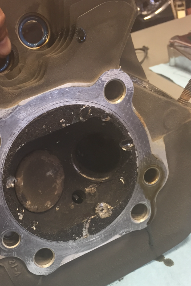

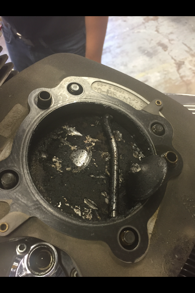

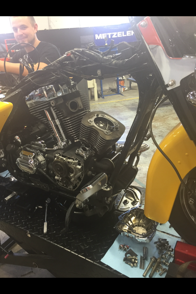

Originally Posted by ChopinRockwooD
Enjoying a ride the othe day and my 2005 RK Custom started losing power like it was out of gas. I get it off the road and it dies.
My Indy starts pulling it apart and this is what they see.
I just spent 10 grand on new a baker 6 speed, paint, apes, and other improvements last winter.
The engine was worked on 5 years (cams, heads, etc)
What would you do? Put another 6-10 grand into the engine and sell it or keep it. That would be app. 20 grand since May.
Or sell it as is with blown motor.??
p.s. My wife is not too thrilled right now.
Piston, e-bay head, and some gaskets.......insure the rod isn't bent and your back is business?
Seen worse that are now running well.
Scott
Scott
Thanks Scott, I really do feel much better just looking at your credentials.
I would like to get the same amount of power that I had (app. 125hp). Hopefully rebuilding my old engine for a few grand will get it back on the road this year . If its going to cost over 5 then it will be a winter project with a new engine.

Check the crank runout and hope it falls at or below .003" and not the updated tolerance of .012".

We have witnesses on more than one occasion, even OE valves break/springs break on heads that come in here for repair.
When a valve becomes wadded up in the chamber like that, always check that rod for straightness/square to the cases deck.
Scott
