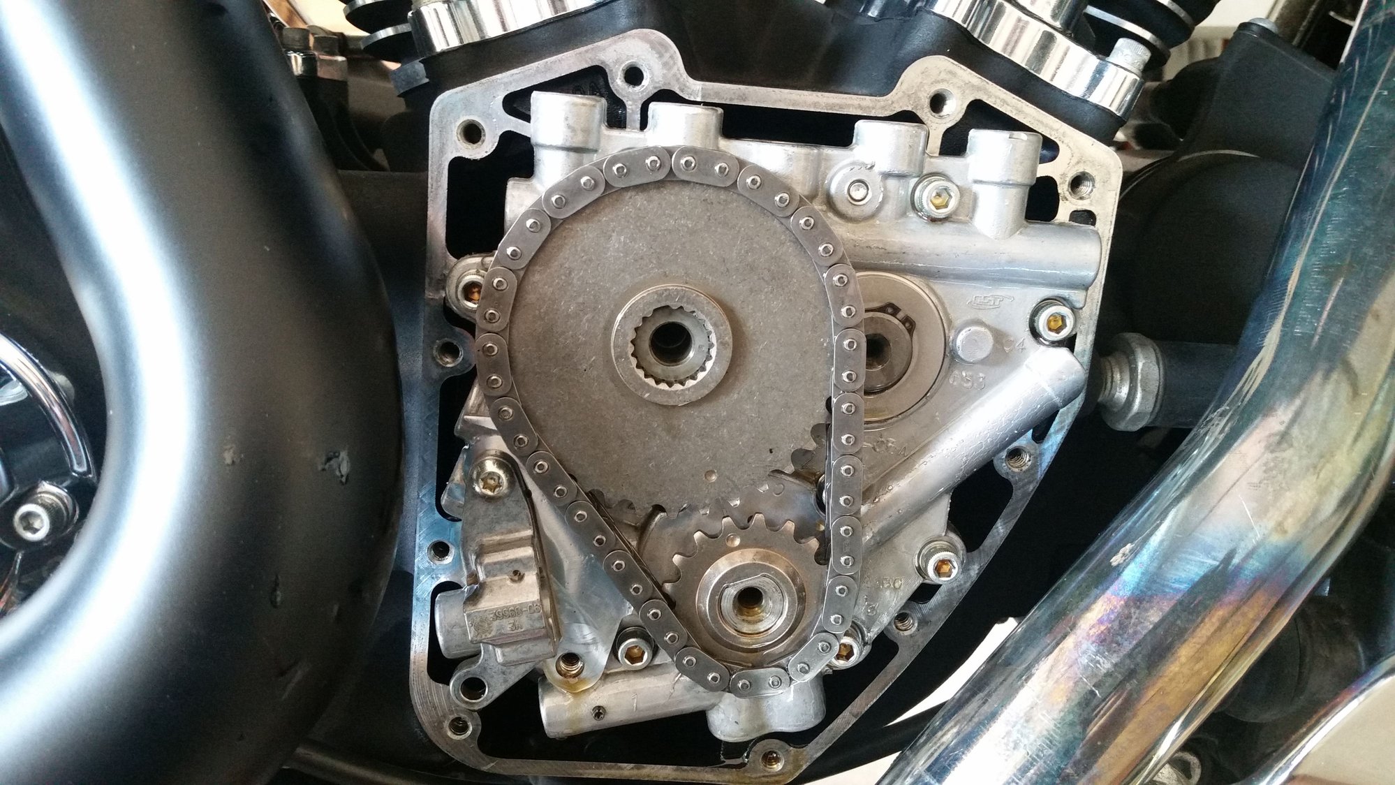

F it. Opening cam chest. Doesnt take long

Odd thing. The chain is tight on left side w out tensioner.

Old Oct 18, 2016 | 05:28 PM
  #40
Fblo1690's Avatar
Fblo1690
Joined: May 2012
Posts: 1,001
Likes: 107
From: Houston
Hm. I cant line the cam dots up with the rockers still on...man o man.
