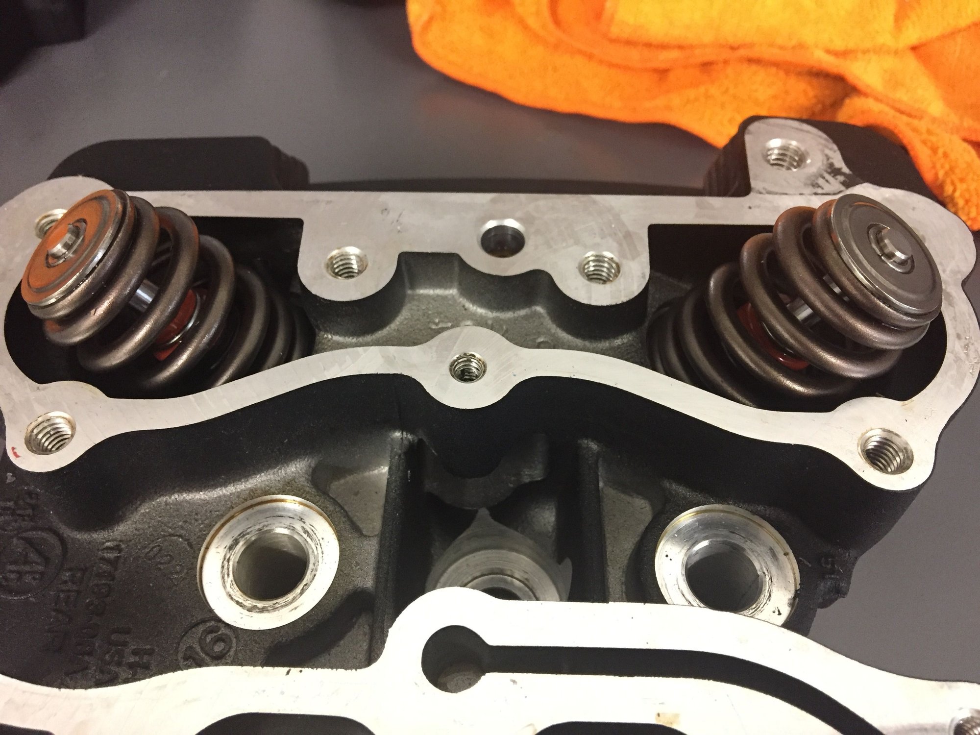

Stock head and springs off a 103B

Originally Posted by Breakout110
What's the seat pressure on the stock beehives on a 103? don't think we are taking about the same beehive springs... There is a different High Perf. spring userd in the SE110 that's a beehive also. Installed at 208lbs on the seat.
Stock beehives on 96/103 motor are about 135# on the seat; 325# at full lift on stock cams which is shy of .500". Five years back, the conventional "wisdom" was that stock springs were acceptable up to .560" lift and .575" lift was the break point where stronger springs were required. About that time, Mr. Woods changed his break point for stiffer springs to .590" lift and we all know that his cams are known for the aggressive ramps.
JMHO but stiffer springs add to valve train noise and also beat up valve seats and unless one is drag racing or constantly running up against the rev limiter and needs to control valves at high rpms, OEM springs will get the job done without that added angst. Most of the motor configurations we see discussed on this forum will do just fine with OEM beehives and the OP's motor with Andrews 48 cams just doesn't need stiffer springs. No issue with anyone that wants to install stiffer springs, I just don't subscribe.
I have seen guys come into a local indy shop after insisting on stiffer valve springs only to return a few weeks later complaining of valve train noise. The indy replaces the stiffer springs with the OEM beehives, problem solved. Motor runs just as good, and owner is happy.
NOTE: My reference to "conventional wisdom" refers to valve spring rate discussions from different HD forums over the years and I make no claim to the accuracy of "conventional wisdom" but the posts I paid attention to were those posted by reputable builders/porters........

Thanks for the info djl. I do have the upgraded springs and yes the valve train is much more pronounced as you might hear at idle before this little wot romp.
I do ride hard with a few Victory and other HD riders.
