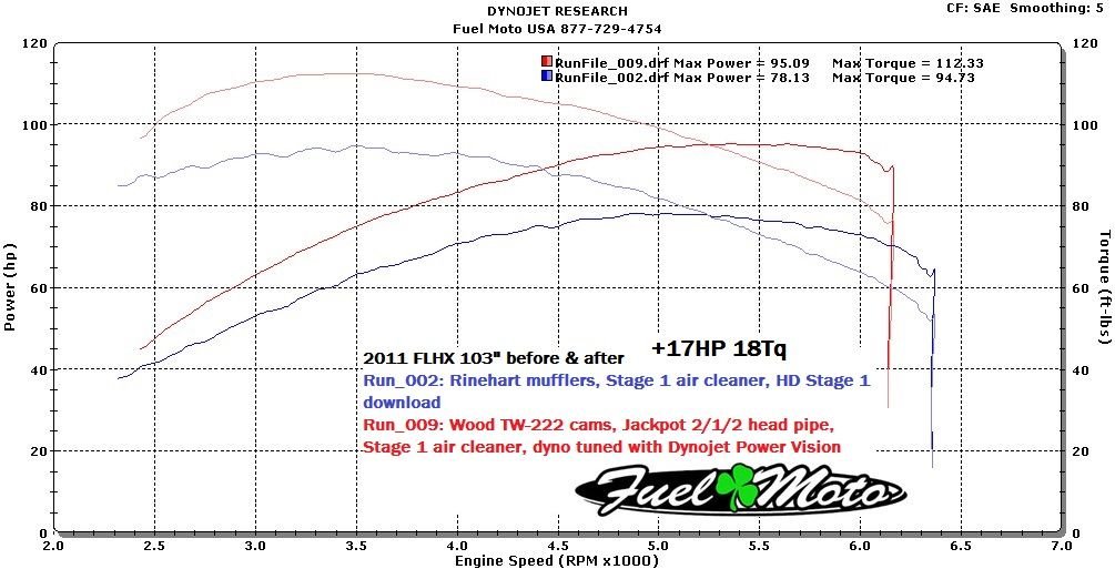

Sorry for the resurrection, but I decided to go with the 4" Rineharts, and without even tuning it, there's a massive difference in low end torque. Fuel Moto has my exact set up, with the Power Vision Tuner, making 95/112! But the kicker is, that it hit's 100lbs. at 2500 RPM's. I ordered the tuner, and will have it on Tuesday.

I’m still waiting on dyno charts for the 48’s.
