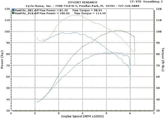

Originally Posted by ntraindavefl
I have never seen a cam only 103 break 100 hp. Not sure any of them can. Some at 98 but that's best I've seen 2500-4500 rpm is what counts anyways for the street build.
Here you go. It surprised me to see 100 hp as well, but it's doable, probably not very common at all though. Dyno'd with Rinehart duals and high flow air filter, otherwise stock. I'm betting however, it took a good bit of tuning to get it to this point. Wes Brown sent this to me:

I'd bet Pam Brown takes all the credit. Lol
SAE is the standard, hp would be 98
Still that's a good cam and a few others would show similar
