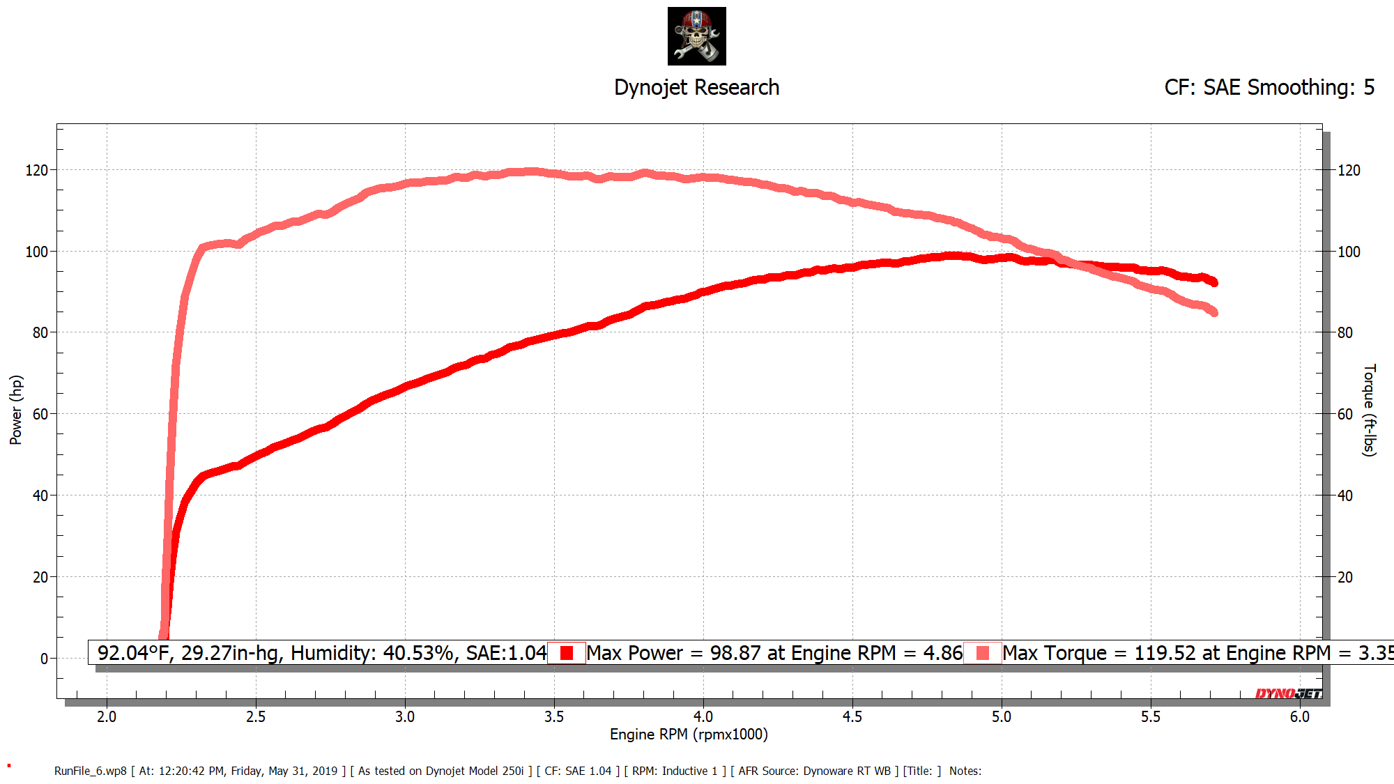

Well, here is the second one I promised. This is the RS587 bolted into a stock 110" with the stock 110" A/C with a K&N in it and V&H true duals with V&H twin wall rounds.....Obviously the exhaust would not be my first, second, or third choice for this (or any) bike but it was on there when my customer bought the bike used. Oh yeah, the bike is a 2011 CVO Ultra CLassic.

An S&S .570 at 10.2 cr hits like that, pushing up to at/near 125 ft/'lbs, but brings about 115 hp into the picture, with the use of a 58mm t/body.
The exhaust timing of the .570 helps reduce unwanted heat.

So completely stock compression? Approximately where do these 110 motors come in stock? Are the 110 S motors the same?

Compression would have to be addressed to take full advantage of the 570 in a CVO or S motor application?
