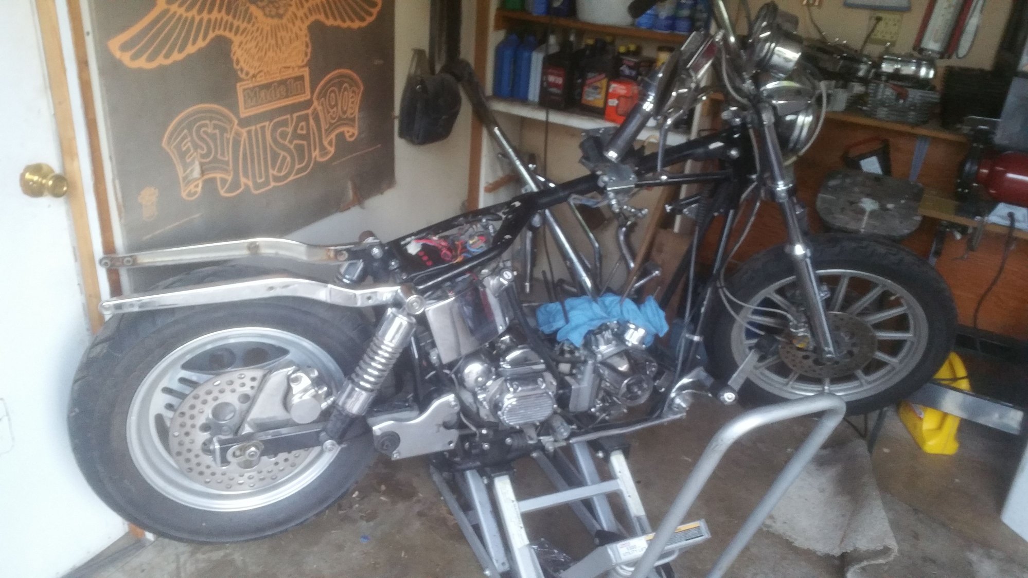

So I know I'm new here but I have been searching for hours on any kind of information on relocating oil passages for 3 13/16 axtell cylinders. I traded my father my sporty for his "92 Softail" I say this in quotes because the bike is a conglomeration of different years and parts. The motor is my main priority because this thing has leaked oil from the head gaskets since it was built in the mid 90s. My father finally gave up trying to fix it and just let it sit. Well I wanted to rebuild it and make it rideable last year. Put all new gaskets on it from base cylinders up. Thought I had it but 100 miles later it started seeping and 200 miles later it looks like the rear of the bike was dipped in oil after a 10 mile ride. I just started tearing it down and pulled the heads again. I see no reason for it to be leaking oil this bad. I am taking the heads in tomorrow to have them checked but it is leaking from the oil passages. I read on one of the sites that its no big deal to run external returns but I haven't found anything as far as how to do it or even someone that has done it. This was from last summer
After rebuild and paint

I gotta tell ya, that is one sweat looking ride... I'd love to see more pics, if you don't mind...

Well my dad actually couldn't ride it anymore due to cancer and having radiation treatments in his legs he couldn't hold it up so that's why we traded. Right now that's the only picture I have of it. There will be more taken once it's done in a few weeks. Still looking to modernize the front end but all the wiring goes into the headlight. I downsized the mess of wires that used to run into it but still more than I want showing. Going to pull the front end rake it 3° and drop the tail. That probably won't happen till winter though. I need to ride!
