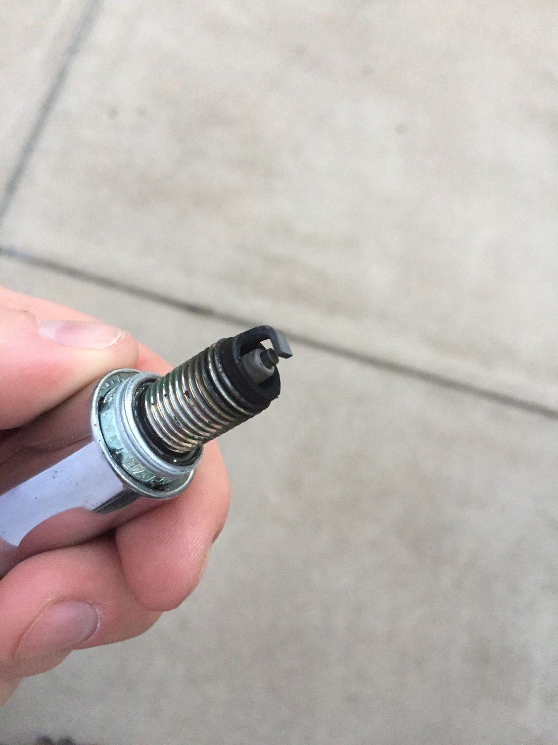

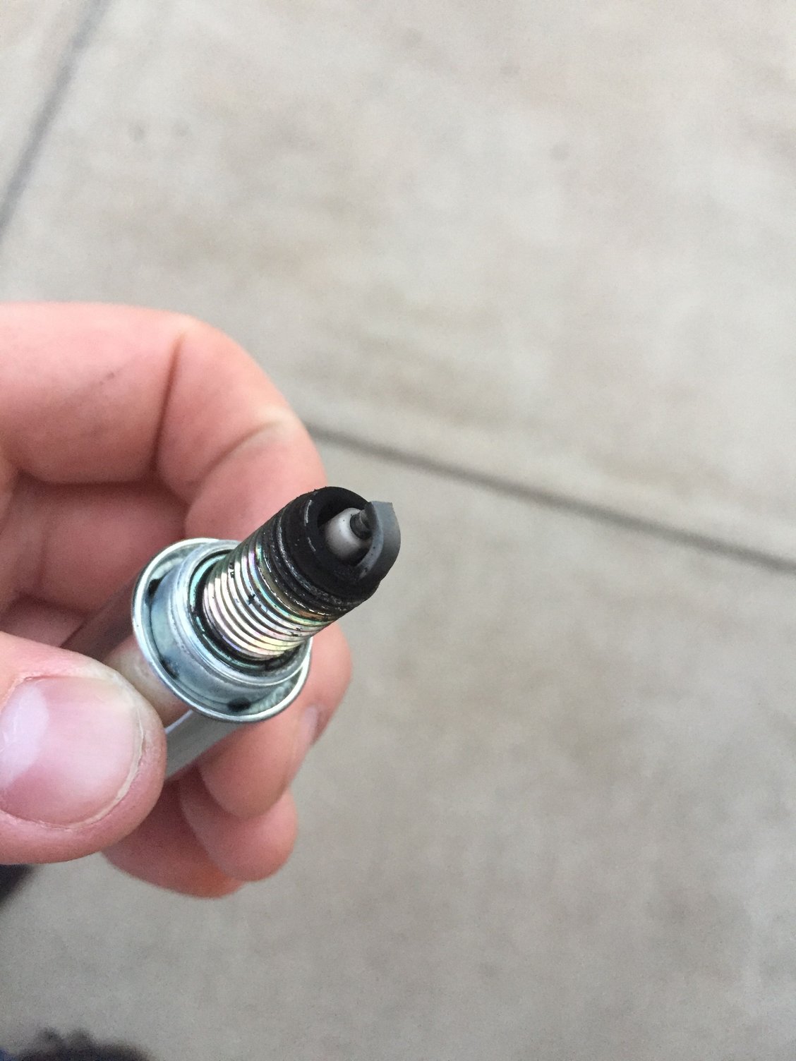

I'd recommend you pull the plugs and let's have a look...

Back
Back
Front
Front
Front

i took these photos 2 months ago when I started to notice the sound. I was getting slightly white exhaust smoke. soon after I cleaned intake filter and ran a drip line from breather bolts. Exhaust smoke stopped and haven't checked plugs since.

I've not worked on sportsters for some time but it sounds like you have a typical motor issue..
If you have a knock on the front cylinder that increases with load (accelerating), I would suspect that you might have scuffed a piston.. Plugs actually look a little rich with the front looking worse which might be the results of poor compression and some oil bypassing the rings.. Oil blowing out the breather can be indicative of poor ring seal. This again is possible indication of a scuffed piston. The knock could be from excessive carbon build up..
